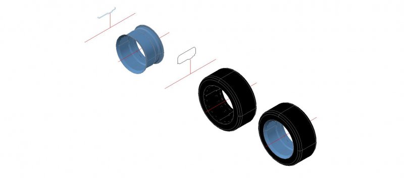

ReMark Posted October 7, 2011 Posted October 7, 2011 A simple rim and tire I did in about 90 seconds. I drew the rim profile then revolved it. I drew the tire profile and revolved it as well. Combined the two together for final product. Got it? Quote
miedy12 Posted October 7, 2011 Author Posted October 7, 2011 lol remark hat a shame on me perfect wheel yeah can u put some innards on wheel? hey how did u combine them? plss help me. what is the pink line thingy there? Quote

ReMark Posted October 7, 2011 Posted October 7, 2011 lol remark hat a shame on me perfect wheel yeah can u put some innards on wheel? hey how did u combine them? plss help me. what is the pink line thingy there? I was merely illustrating a point about creating the rim and tire using a revolved profile. The red "thingy" as you call it was the line that I used to revolve my profiles around using the "Object" option of the command. I did not combine them in the sense of doing a "union" between the two. All I meant was that I copied the rim and tire to a different location and matched them up. That's all. They are two separate entities. Quote

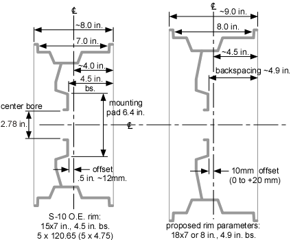

miedy12 Posted October 10, 2011 Author Posted October 10, 2011 does anyone knows where f7 got a picture? im trying to find with measurement Quote

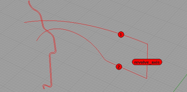

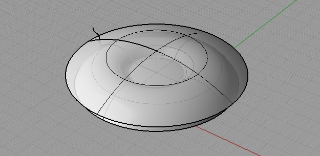

miedy12 Posted October 10, 2011 Author Posted October 10, 2011 hey jack thanks but can i ask some question i got some tutorial in rhino3d dont know if acad and rhino have similarities but im confusing about this image im confusing the red line revolving axis with a number 1 and 2 should i draw like that so that my rim will bend upper like that? see the picture and also in this tutorial can i make something like this in acad? http://www.toxiclab.org/tutorial.asp?ID=122 TIA Quote

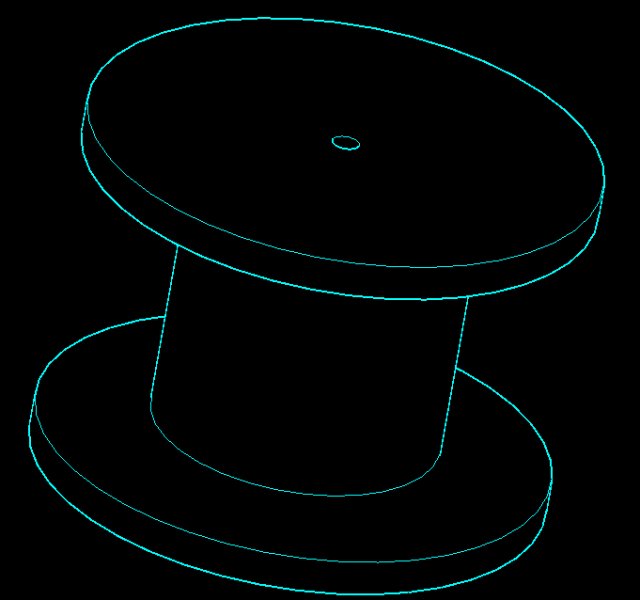

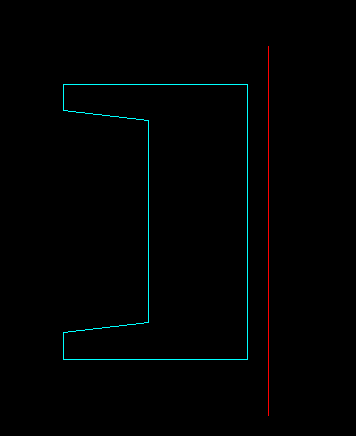

Jack_O'neill Posted October 10, 2011 Posted October 10, 2011 hey jack thanks but can i ask some question i got some tutorial in rhino3d dont know if acad and rhino have similarities but im confusing about this image im confusing the red line revolving axis with a number 1 and 2 should i draw like that so that my rim will bend upper like that? see the picture and also in this tutorial can i make something like this in acad? http://www.toxiclab.org/tutorial.asp?ID=122 TIA I don't know anything at all about Rhino, but maybe I can help you visualize how to use the revolve command. Lets start with a simple shape, a common spool for wire or cable or even sewing thread that looks like this: Now, in your mind, cut that shape in half, so that you are looking at a section view like this: Then cut it in half again: The shape you see above is a closed polyline. I used that so the end result would be a solid. If you revolve individual lines, you'll get surfaces instead of a solid. Use whichever suits your needs. The red line is where the center of the hole in the middle of the spool is located. Type in revolve, select the polyline, then pick the red line. It will prompt you for an angle. If you want a completely round shape enter 360 and hit enter. You should see a the spool appear. If you can picture the shape of your wheel the same way, you should be able to draw and revolve it's basic shape. You'll then have to remove sections to make the spokes, lug bolt holes, etc and there are many different ways ways to do that. Once you figure out how to make the shape you want, we can work on the spokes. Quote
f700es Posted October 11, 2011 Posted October 11, 2011 Here you go as I said before I did not measure it I just traced over it. I did scale it to be 8" wide though. Quote
