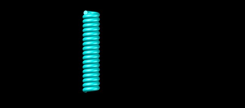

ReMark Posted October 1, 2011 Posted October 1, 2011 Use the HELIX command. Construct your helix then use the SWEEP command to sweep a circle along the path of the helix. Quote

JD Mather Posted October 1, 2011 Posted October 1, 2011 (edited) Helix (not spiral). Sweep the circle. Array (polar) copies (looks to be 5 total, but can't really tell without closer inspection). Slice or presspull or extrude subtract to get ends as shown. (keeping in mind that the 2D is a bit of simplification of real geometry) Post back if you can't figure it out (you might see the tutorials in my signature). Edited October 2, 2011 by JD Mather Quote

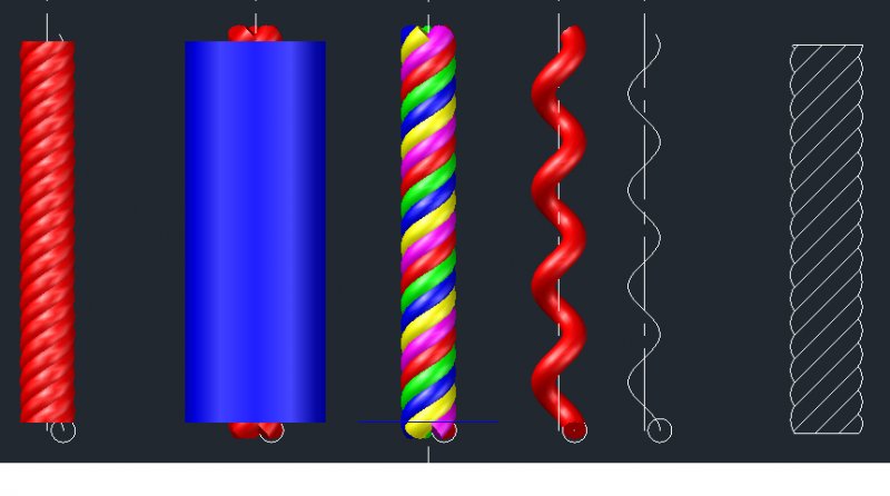

JD Mather Posted October 3, 2011 Posted October 3, 2011 See attached image for steps. (I reversed the image because I had the helix going the wrong direction.) Create the helix sweep path and profile. (pitch 12.125) length > 50 Sweep the circle. Polar array around the centerline 5 copies. (the new array command in 1012 creates a new "array object" (might be a more precise description - but I'm not really familiar with AutoCAD anymore) Explode the array "object". Union the array. Create a circle (blue) (larger than the helix) up one diameter of the profile. Extrude the circle 50. _intersect the two to cut of the ends to desired (50?) length. Quote

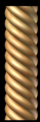

3D generator Posted October 11, 2011 Posted October 11, 2011 I have step by step instructions for drawing a helical column shaft but it's too big to post here. Please feel free to contact me through the forum if you'd like a copy of it. Thanks. Mark Quote
