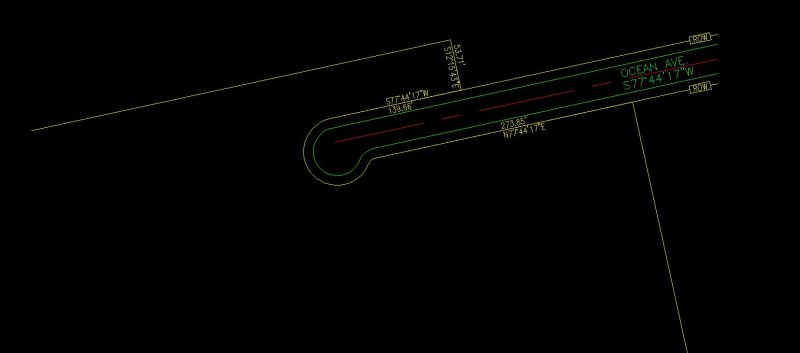

In my booklet it asks me to "draw a 144.32' segment in a counter clock wise direction. then it asks to show the delta angle, the length, and the radius of the curve."
how do u draw it with the instructions its giving me? how do you find out the delta angle, the length, and the radius?
this is not the only problem im facing. as there are 2 more instances where it happens.

please look at Page 16,17. the problems im having difficult with are 4,5, and 10.

That section of the instructions have you drawing the cul-de-sac for Ocean Avenue if I'm not mistaken.
To draw the arc correctly you have to go back and look carefully at steps 1 and 2 on the previous page (15) for further information (hint: radius). Once both curves are constructed you can obtain most of the required information you are being asked to provide via Properties or the List command. You will have to calculate the delta angle from the info given.
