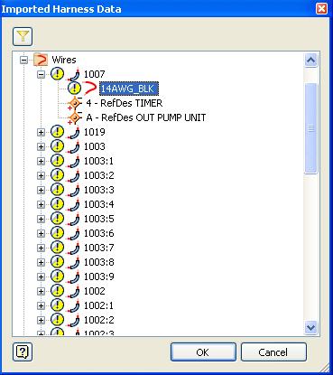

So I've had some measure of success, as I've managed to publish a full electrical schematic using AutoCAD Electrical and I've made it fairly far into my wiring harness project. So far, I've successfully managed to import my wiring information from AutoCAD Electrical to Autodesk Inventor, but not without some minor problems. My reason for this thread posting is actually to address one such problem:
Currently, when I import a wiring report from AutoCAD Electrical to Autodesk Inventor, I have to manually go through every single wire type in my report (from Autodesk Inventor) to match the wire types with those located in the Autodesk Inventor library. I've tried multiple wire Layer Names from AutoCAD Electrical, including identical names to those found under the Generic wire category from Autodesk Inventor's Cable & Harness Library. For example, "14AWG_BLK" and "14AWG-BLK" are among those Layer Names which have been tested. Despite matching Layer Names (AutoCAD Electrical) with Part Numbers (Autodesk Inventor), with case-sensitive and exact precision, wires are still not generated automatically during the Import Harness Data process; it still requires manual matching of wires.

One thing I should have mentioned was that when right clicking the problem wire (the wire in the Imported Harness Data screen) with the exclamation mark next to it as shown below...:

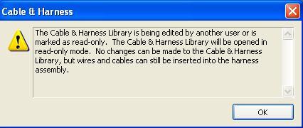

...the option to Add to Cable & Harness Library, when selected, gives the following message,...:
...which I believe is the result of a network error, but am not certain. Alternatively, I can successfully open the Cable & Harness Library as shown here,...:
...but it is in read-only mode, which prevents me from adding anything new to the library. Does anyone have any idea how to make the Cable & Harness Library editable? I have verified that no one else in the building currently has the Cable & Harness Library open, which renders this (search for the word "read-only") unhelpful.

We just figured it out! On the network (which I do not have access to), the .IWL file was checked in the properties as read-only. The network manager went in and created a backup, then unchecked read-only so I can now add new wires to the library. In summary, the solution was the network admin had to change the Cable & Harness Library read-only file "Cable&HarnessDefaultLibrary.iwl" to make it editable by unchecking the read-only box under its properties.
