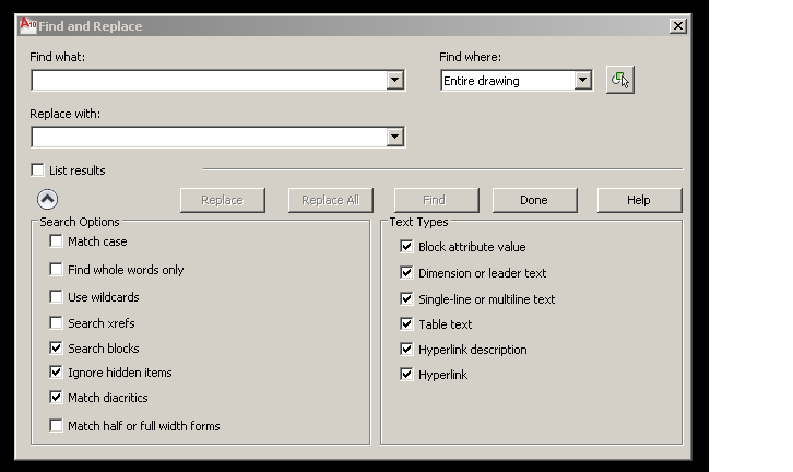

In a drawing I would trying to change #12 to #10 with AutoCAD's search and replace feature and it
did not work. What can be the problem here? It there a good text search replace Lisp or VBA routine
routine that is better than AutoCAD's routine? Is so where is it located on the net?

Use an apostrophe before the # sign, otherwise it is seen as a wildcard, in this case # = any numeric digits.
find
'#12

In the 2010 find and replace dialog, be sure you pull the arrow down that shows your options. It may be that you have something unchecked.

I think the OP has "use wildcards" box checked, they need to uncheck that.
