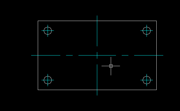

Rectangle, square center line cross lisp?
As per title: anybody got lisp that will draw center line cross for any rectangle or square?
Thank you.

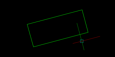

Another Vanilla LISP version for LightWeight Polylines:
(defun c:polycen ( / a b c e l x )
   ;; Example by Lee Mac 2011  -  www.lee-mac.com
   (setq x 0.1) ;; Line Extension
   (while
       (progn (setvar 'ERRNO 0) (setq e (car (entsel "\nSelect LWPolyline: ")))
           (cond
               (   (= 7 (getvar 'ERRNO))
                   (princ "\nMissed, Try again.")
               (   (eq 'ENAME (type e))
                   (if (not (eq "LWPOLYLINE" (cdr (assoc 0 (entget e)))))
                       (princ "\nInvalid Object.")
   (if e
           (setq l
               (apply 'append
                   (mapcar
                       (function
                           (lambda ( x )
                               (if (= 10 (car x)) (list (trans (cdr x) e 1)))
                       (entget e)
           (setq l
               (mapcar
                   (function
                       (lambda ( x )
                           (apply 'mapcar (cons x l))
                  '(min max)
           (setq c
               (apply 'mapcar
                   (cons
                       (function
                           (lambda ( a b ) (/ (+ a b) 2.0))
                       l
           (setq a (* x (- (caadr  l) (caar  l)))
                 b (* x (- (cadadr l) (cadar l)))
           (entmakex
               (list
                   (cons 0 "LINE")
                   (cons 10 (trans (list (- (caar  l) a) (cadr c)) 1 0))
                   (cons 11 (trans (list (+ (caadr l) a) (cadr c)) 1 0))
           (entmakex
               (list
                   (cons 0 "LINE")
                   (cons 10 (trans (list (car c) (- (cadar  l) b)) 1 0))
                   (cons 11 (trans (list (car c) (+ (cadadr l) b)) 1 0))
Should work in all UCS/Views and all shapes of Polyline.
