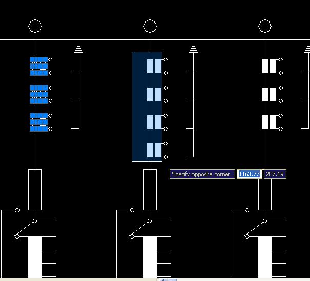

maybe if you see these examples you understand wath as i said.
i put some notes in the drawing 1 too explain my problem.
once again the drawing 2 it's my goal. so far I use the function too recreate the boundaries and after i delete the old boundaries(if exist) and the hatch's like this

Bottom line, recreate boundary for selected hatch,
No Boundary---> Create and move to "cheio" layer
Existing Boundary found --> move to "cheio" layer
You can combine Alanjt's and GP_'s code.
Easiest way would be recreate boundary regardless if the boundary exists or not while current layer is "cheio" ,
Erase objects utilizing filters to exclude "HATCH" and layer ""cheio", including hatch within thefilter is important as an exisitng boundary may have the same layer as the hatch entity, keep in mind that there are no entities on "cheio" layer to start with for this to be effective.

is exactly one function of this genre that I need, but it is only possible for rectangular hatch's not me is very useful :ouch::ouch::ouch:
but thank you for your interest

Not delete the old boundaries :(
Oh i see.
I tested the code on your posted DXF sample
I noticed that the color of the boundaries of the "letters" hatch are white and not by layer. it worked well with that sample.
I'll take a look at the other samples.
Which sample did you try the code on Luis?
EDIT: I noticed that the hatch on sample hatch1.dxf are not associative
We'll try to find a way around this. but next time make sure when you use associative OK?

Hi Alan,
This code is something similar to what i'm after only.
I was hoping to have it so my hatch objects are already selected via other lisp functions I have for filtering hatches and then run the command and so selects the boundaries of those hatches.
Note: All boundaries have associative hatches to them.
I've tried to get this to work with my limited knowledge but it only works for one of the selected hatches.
It works if I have the object selected first which is what I was after.
I just need the functionality of it working with more than one hatch selection.
Thanks.
Code I've so far:
