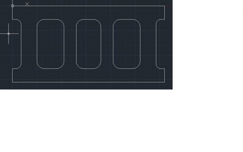

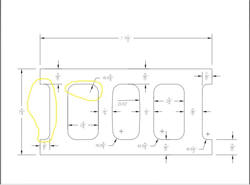

dillcad Posted September 24, 2011 Share Posted September 24, 2011 How would i draw the things circled in yellow. Im guessing it has to do with the ARC command. I have everything else drawn up but if someone could help me find out how to draw the curved pieces in yellow that would help. Thank you. Quote Link to comment Share on other sites More sharing options...
ReMark Posted September 24, 2011 Share Posted September 24, 2011 I'm assuming that at this very moment you have right angles where those corners should be which means you could use the FILLET command and specify the RADIUS. You have to watch where you make your picks though so you don't get an unexpected result. Another option would be to draw a circle and trim away what you don't need and of course there is always the ARC command which has several different options. There are probably two other ways to do it that I haven't even thought of yet. Quote Link to comment Share on other sites More sharing options...
dillcad Posted September 24, 2011 Author Share Posted September 24, 2011 I'm assuming that at this very moment you have right angles where those corners should be which means you could use the FILLET command and specify the RADIUS. You have to watch where you make your picks though so you don't get an unexpected result. Another option would be to draw a circle and trim away what you don't need and of course there is always the ARC command which has several different options. There are probably two other ways to do it that I haven't even thought of yet. Yeah that is what i have right now. Quote Link to comment Share on other sites More sharing options...
ReMark Posted September 24, 2011 Share Posted September 24, 2011 Then I guessed correctly didn't I? Well, try the FILLET command and specify a 1/2" radius making your picks just to either side of the intersection of the right angle. Quote Link to comment Share on other sites More sharing options...
dillcad Posted September 24, 2011 Author Share Posted September 24, 2011 Then I guessed correctly didn't I? Well, try the FILLET command and specify a 1/2" radius making your picks just to either side of the intersection of the right angle. Thank you mark. You have been huge help, now i can finish this project. Quote Link to comment Share on other sites More sharing options...
ReMark Posted September 24, 2011 Share Posted September 24, 2011 Sure thing dillcad. Good luck with the rest of your project. Quote Link to comment Share on other sites More sharing options...
dillcad Posted September 24, 2011 Author Share Posted September 24, 2011 Sure thing dillcad. Good luck with the rest of your project. thank you once again. Quote Link to comment Share on other sites More sharing options...

eldon Posted September 25, 2011 Share Posted September 25, 2011 It looked to me, from the first picture, as if the sides of the central hole (red in my picture) should have a radius of 2'. Your sides look parallel. Quote Link to comment Share on other sites More sharing options...
JD Mather Posted September 25, 2011 Share Posted September 25, 2011 Good catch - hope the OP sees this as I'll bet a good portion of the class misses this. Quote Link to comment Share on other sites More sharing options...
SLW210 Posted September 26, 2011 Share Posted September 26, 2011 If this is a school project, please give the course. Also note that the radii are 3/4" for the interior holes, hopefully that wasn't missed. Quote Link to comment Share on other sites More sharing options...
Tankman Posted September 30, 2011 Share Posted September 30, 2011 Picky, picky, picky! Good catch! Looks like a cinderblock. Quote Link to comment Share on other sites More sharing options...
