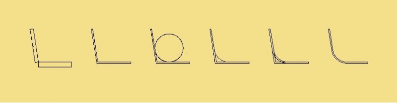

Ollie8974 Posted September 22, 2011 Posted September 22, 2011 Is this what you are trying to do? 1 draw the seat back 2 off set the thickness of the seat back material, in this example I used 3/4inch. 3 open the draw a circle menu choose the tan,tan ,radius circle. the instructions will ask you of indicate the two insertion lines. click any place on the two seat backs the instructions will then ask for the radius. I used the radius of 13 7/16 given in your plans. Trim away the circle leaving the radius in image 3. offset the radius the thickness of the seat back material. In this example I used 3/4 inch. Now trim away the seat back, using the radius, as in image 6. Quote

Ollie8974 Posted September 22, 2011 Posted September 22, 2011 I thought the OP wanted the seat profile to be curved. Either way the above method will work. Quote
Jack_O'neill Posted September 22, 2011 Posted September 22, 2011 I thought the OP wanted the seat profile to be curved. Either way the above method will work. After I saw what you did, I began to think maybe I misunderstood and what you did was what he wanted. The radius he gave in the original post won't fit if you do that though. I thought he was having trouble with the curved portion of the seat back. Oh well, maybe he'll pop in here in a bit and help us out. I've had way too much allergy meds the last couple of days to be sure of anything! Quote
