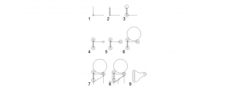

how do i array them correctly with them evenly spaced between 68 ,center line to center line. I have to run my son to practice i will be back in 15 min
ARRAY command. This is what the inputs (in bold) will look like at the command line. It is assumed you have already drawn the bottom circle.
Select objects: pick the circle that you drew
Enter the type of array [Rectangular/Polar] : R
Enter the number of rows (---) : 5
Enter the number of columns (|||) accept the default
Enter the distance between rows or specify unit cell (---): 17
There are other ways to accomplish the task.

Something was amiss with my previously posted image so I have taken the liberty of reposting at a larger scale.
Personally, I think you'll find problem 4-26 too difficult to do on your own unless you are sitting with someone who is more experienced using AutoCAD or you see it done in a video. I'm about two steps away from completing it myself and even if I laid it out in the same manner as problem 4-24 I still think you would have trouble doing it. I'm having a problem reading a couple of the dimensions. A second, better, image would be a big help. Hint. Hint.

My attempt at problem 4-26 came out looking like this. There were two numbers I had trouble reading so this may not be an exact match.
