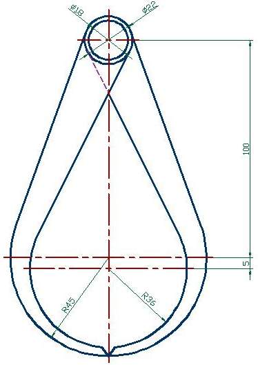

LOST NEWBIE Posted September 21, 2011 Author Posted September 21, 2011 Something like this. Where do you begin if your professor wants you to draw it to the give dimension? Quote
ReMark Posted September 21, 2011 Posted September 21, 2011 (edited) Nice set of calipers. What do you want to know? Hint: When it comes time to put in the straight line segments make use of the Tangent option. Got to run. Catch up with you later. Edited September 21, 2011 by ReMark Quote

Ryder76 Posted September 21, 2011 Posted September 21, 2011 (edited) I was able to draw this with the exception of the bottom "V" of the caliper. The dimensions are lacking to do that part. I started with a circle and offset to get the two top circles. Then I drew a center line and offset to the bottom distances I needed did two more circles and four lines tangent to the circles. Used break at point and made line hidden then dimensioned everything. Took me about 5 minutes - YMMV. new block.dwg Edited September 21, 2011 by Ryder76 spelling dangit Quote
ReMark Posted September 21, 2011 Posted September 21, 2011 Post #15 (second image). Some information is missing. Quote
