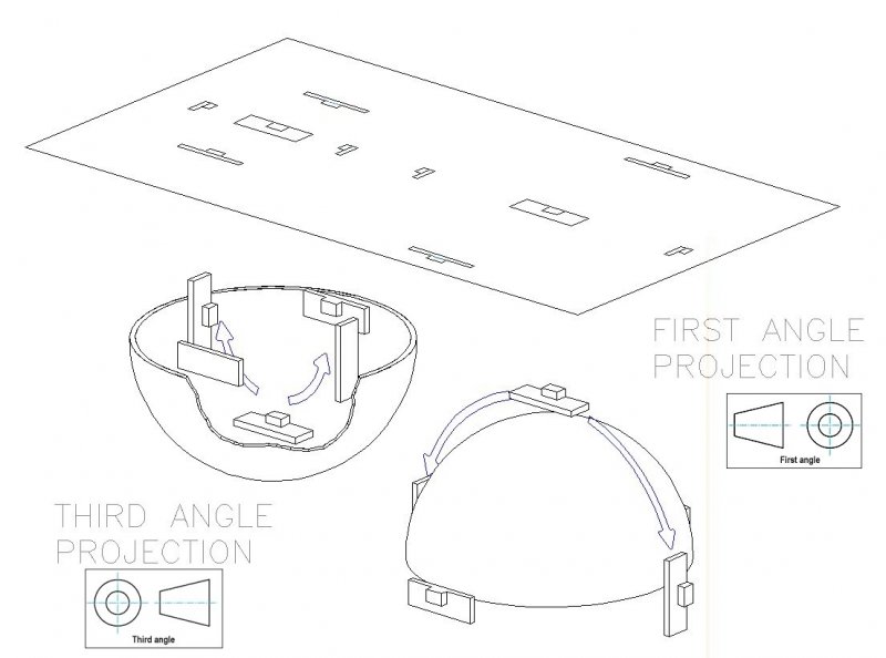

Patrick Hughes Posted September 20, 2011 Posted September 20, 2011 I've got to disagree rkent - that is third angle projection. Something I've found to be useful to differentiate the two is if you mentally place an object in an imaginary bowl as you slide the object up the wall of the bowl that will produce a third angle view. Now if you invert the bowl and place the object on top, as you slide the object down the bowl wall it produces a first angle view. Quote

Patrick Hughes Posted September 20, 2011 Posted September 20, 2011 Well the OP actually had it right - it is altogether wrong. The left side view does appear to be the right side view placed on the left. That in itself does not make it a first angle view. If it were a first angle view the "plate" portion of the object would be nearer the plan view (use my bowl visualization). Also look at the partial front view - that is third angle. Quote

Patrick Hughes Posted September 21, 2011 Posted September 21, 2011 (edited) JD Mather said: Why doesn't someone simply model the part using a modern MCAD program like Autodesk Inventor to create both 3rd angle and 1st angle projections to verify? Why do you need a modern program? This was done in r14: Edited September 21, 2011 by Patrick Hughes Oh Snap. I didn't see your image. Quote

rkent Posted October 13, 2011 Posted October 13, 2011 Patrick Hughes said: Why do you need a modern program? This was done in r14: [ATTACH=CONFIG]30116[/ATTACH] Patrick, Very nice illustration, makes things easy. rkent Quote
