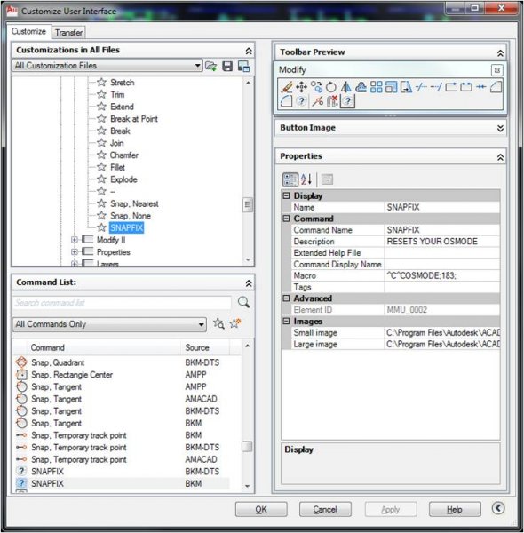

Ryder76 Posted September 19, 2011 Share Posted September 19, 2011 So what do you mean by "smart" tool palette? Sometimes lisp routines can change the osmode settings. I created a command button that sets my osmode to what I like and put it on my toolbar. Now I can reset my osmode quickly. Quote Link to comment Share on other sites More sharing options...

Ryder76 Posted September 19, 2011 Share Posted September 19, 2011 Take a look... Quote Link to comment Share on other sites More sharing options...
