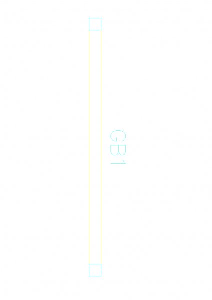

need : set 2 layer in mline

thank you , but i hope funtion justify to bottom , top and zero

thank you . very cool lisp , please insert auto hatch fuction between inner line (layer"0")

yes. it work on setting layer and please set hatch angle 135 degree. very thank you.
