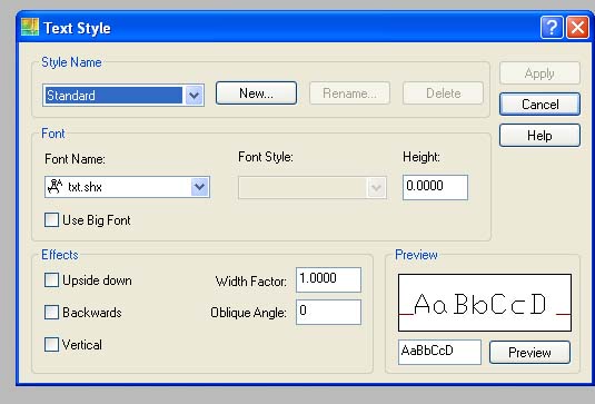

There is only one font listed there; it is Standard. That has been the case after an initial install, and two subsequent uninstalls and installs.

I didn't think that there was a font called Standard. There is the default Text Style which is called Standard, and that has a default font txt, which can be altered - explore the scroll button. :)
Strange indeed. I can't think of one reason why AutoCAD would not load all of its standard fonts. Is this a standalone or networked computer? If you check under Options > Files what is the path for fonts shown as? Using Explorer check the contents of the font folder. What do you see (or not see)?
AutoCAD 2004 has about 39 .shx files in its fonts folder. The font folder is located here C:\Program Files\AutoCAD 2004\Fonts.
