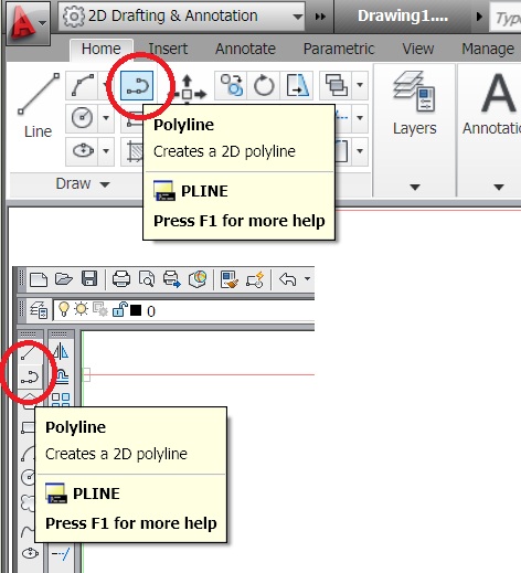

I'm working with ACAD 2011. How can i change the line tool to pick a polyline every time i press the line button?? It's simply because I'm tired of the pulldown menu. I know the shortcut but I would like to be able to pick it in my ribbon as well..
go to CUI > Ribbon > Panels > Home 2D Draw and replace the LIne icon with the Polyline icon.
PL or POLYLINE from the command line, or pick the polyline button.
