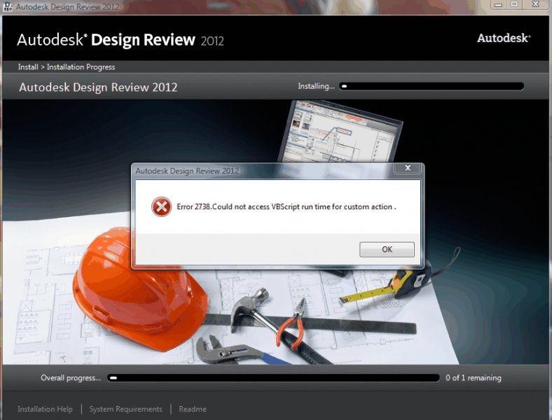

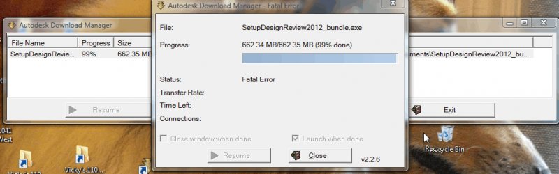

vickyd Posted September 14, 2011 Share Posted September 14, 2011 I've been trying to download ADR 2012 from Autodesk with no luck! I haven't had any success from Autodesk themselves, I've checked Autodesk forums for solutions, I've posted questions to solve the error problems to no avail. Since I've been researching my dilemna, it looks to me like many others are having some of the same problems with downloading successfully ADR? I originally used ADR 2009 until my pc went in for a clean and now I haven't been able to install any of the ADR programs.... My problem is; I need this program to open the mark-ups from clients who do not have AutoCAD (since they're Free viewers)! I work with AutoCAD LT 2011. I been able to install Autodesk's 'DwgTrue View 2012' with no problem. The problem is...that program will not open DWF files to allow me to view the revisions! Just wondering if anyone has had the same issue? Frustrated & looking for some help... Quote Link to comment Share on other sites More sharing options...

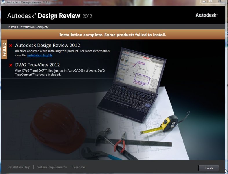

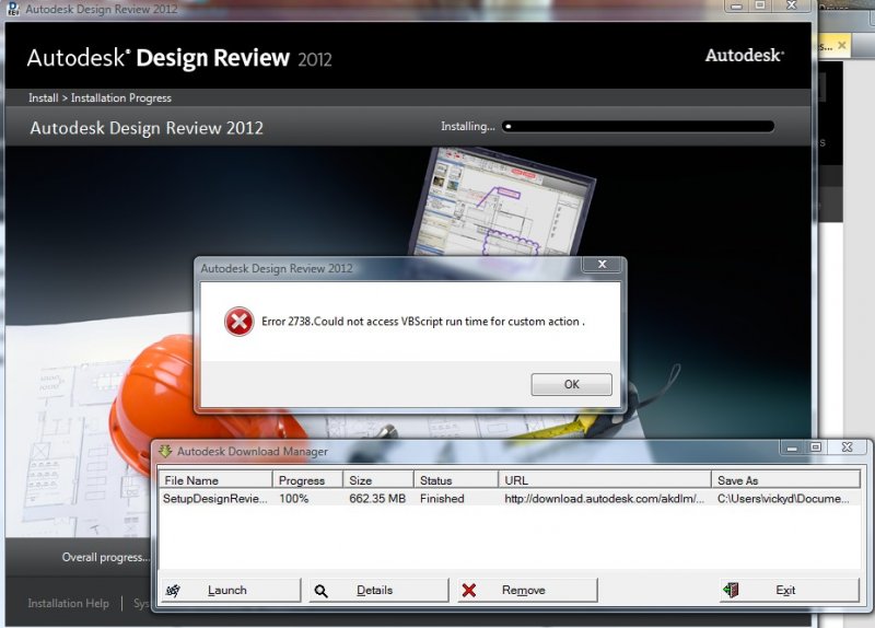

vickyd Posted September 14, 2011 Author Share Posted September 14, 2011 in response to 'Cad64'... I've been able to download ADR 2012 bundle but it's when I tried to install I always get error messages...see attached also I've had this error 2738, see attached... it's been very frustrating & I've checked Autodesk forums, posted queries for answers...no luck any thoughts???? Quote Link to comment Share on other sites More sharing options...

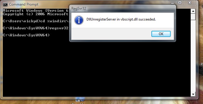

ReMark Posted September 14, 2011 Share Posted September 14, 2011 You just have to look in the right place. Try this...http://usa.autodesk.com/adsk/servlet/ps/dl/item?siteID=123112&id=15102758&linkID=9240617 Quote Link to comment Share on other sites More sharing options...

vickyd Posted September 15, 2011 Author Share Posted September 15, 2011 Well I tried the link "ReMark" suggested (btw Thanks!) and followed the instructions. I unregistered the 'vbscript.dll' successfully & then registered as administrator 'vbscript.dll' successfully, did a reboot. I've downloaded the "SetupDesignReview2012_bundle" (678,246 KB file) successfully and went to install & it came up with the same error....see attached Can any one help me please? my os is vista 64-bit.... Quote Link to comment Share on other sites More sharing options...

dr_josh001 Posted November 21, 2011 Share Posted November 21, 2011 Hi There, Seeing this is an old thread I would hope you've sorted out your problems but I had the same errors and problems come up and gave up. Shortly after I tried to install TRueView 2012 and came up with an error saying I needed ms .net framework ver 4.0 or greater to install. I istalled it and trueview installed. Then I tried installing design review and hey presto!! Here's the ms link to .net: http://www.microsoft.com/download/en/details.aspx?id=17851 Hope this works if you haven't already fixed you prob. Josh I've been trying to download ADR 2012 from Autodesk with no luck! I haven't had any success from Autodesk themselves, I've checked Autodesk forums for solutions, I've posted questions to solve the error problems to no avail. Since I've been researching my dilemna, it looks to me like many others are having some of the same problems with downloading successfully ADR? I originally used ADR 2009 until my pc went in for a clean and now I haven't been able to install any of the ADR programs.... My problem is; I need this program to open the mark-ups from clients who do not have AutoCAD (since they're Free viewers)! I work with AutoCAD LT 2011. I been able to install Autodesk's 'DwgTrue View 2012' with no problem. The problem is...that program will not open DWF files to allow me to view the revisions! Just wondering if anyone has had the same issue? Frustrated & looking for some help... Quote Link to comment Share on other sites More sharing options...
vickyd Posted November 21, 2011 Author Share Posted November 21, 2011 Thanks! I did sort out the problem! Turns out it was McAfee anti-virus software which was causing the problems and not letting it install on my machine! I uninstalled McAfee and loaded it on my machine with no problems! Very odd though since I'd had it on my machine previously.... Hi There, Seeing this is an old thread I would hope you've sorted out your problems but I had the same errors and problems come up and gave up. Shortly after I tried to install TRueView 2012 and came up with an error saying I needed ms .net framework ver 4.0 or greater to install. I istalled it and trueview installed. Then I tried installing design review and hey presto!! Here's the ms link to .net: http://www.microsoft.com/download/en/details.aspx?id=17851 Hope this works if you haven't already fixed you prob. Josh Quote Link to comment Share on other sites More sharing options...
