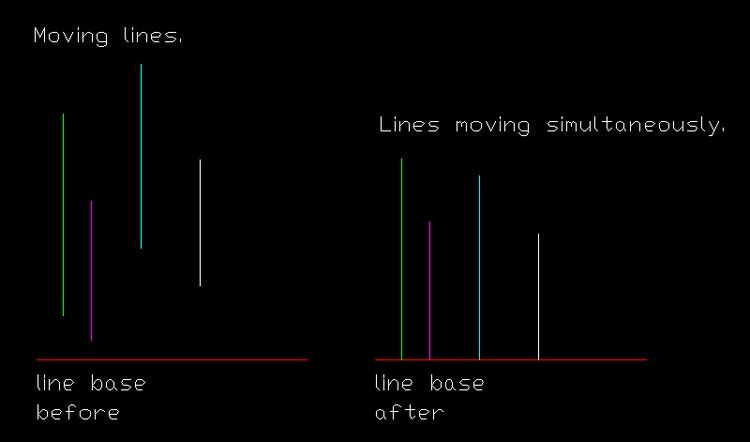

Dear masters Autolisp:
We needed to help me. I need a routine that allows to move a selection of lines, making align its edges with a specific alignment base. It will be similar to the function extends / fence, but only with the result of moving.The length of the lines to move should not be changed.
There should be an option to align a given alignment to left, right, top and bottom.
It will be more versatile if the angle of alignment base can be selected but for now just to me that the movement is perpendicular to an alignment.
I enclose a picture to better understand what is intended.

My knowledge of AutoLISP, are basic. Thank you for the link, I already knew.
Without your help just two years from now will be able to develop.

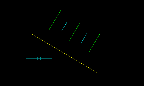

This was quite interesting to write:
;; Example program by Lee Mac 2011  -  www.lee-mac.com
(defun c:MoveLines2Line ( / en in ip p1 p2 p3 p4 ss )
   (if
       (and
           (princ "\nSelect Line to Move Lines to...")
           (setq en (ssget "_+.:E:S" '((0 . "LINE"))))
           (princ "\nSelect Lines to Move...")
           (setq ss (ssget "_:L" '((0 . "LINE"))))
           (setq en (entget (ssname en 0))
                 p1 (cdr (assoc 10 en))
                 p2 (cdr (assoc 11 en))
           (repeat (setq in (sslength ss))
               (setq en (entget (ssname ss (setq in (1- in))))
                     p3 (cdr (assoc 10 en))
                     p4 (cdr (assoc 11 en))
               (if (setq ip (inters p1 p2 p3 p4 nil))
                   (entmod
                       (cons (assoc -1 en)
                           (if (< (distance ip p4) (distance ip p3))
                               (list
                                   (cons 11 ip)
                                   (cons 10 (mapcar '+ ip (mapcar '- p3 p4)))
                               (list
                                   (cons 10 ip)
                                   (cons 11 (mapcar '+ ip (mapcar '- p4 p3)))
My mediocre attempt:

The routines of alanjit and pBe, work well. Corresponds to what I needed.
The Lee Mac routine is not working well. I can not understand why. Have problems in the selection of lines and the routine is interrupted. To select a line, i need to pick twice.
Tanks.
All is working well for me, moving lines at any angle:

You're right. The problem was the order of selection. It was the first select lines to move.
Thanks for the help.
