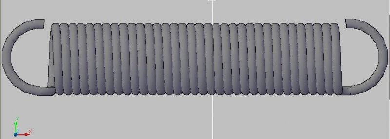

Rewind23 Posted September 14, 2011 Posted September 14, 2011 Hi there, wanna ask some advise on how you guys do this on 3d modelling.Im currently working with this drawing and having some hard time to get this right. I want to create a 3d model of Tension Spring, i was able to create the tension spring but i cant create and connect the end hook on both ends of the spring. I attached the file for your reference.Thanks in advance.more power! 3DTSPRINGWITHENDHOOK.dwg Quote
SLW210 Posted September 14, 2011 Posted September 14, 2011 Why not just draw the entire path and sweep? Quote
JD Mather Posted September 14, 2011 Posted September 14, 2011 Why not just draw the entire path and sweep? I think it will take more than one sweep in AutoCAD. Quote
nestly Posted September 14, 2011 Posted September 14, 2011 Putting a hook on a real spring with a pair of pliers is really easy, but I'm not really sure how you'd draw a smooth transition from the coil to the hook? Quote
Rewind23 Posted September 15, 2011 Author Posted September 15, 2011 Why not just draw the entire path and sweep? Thanks man..il try it..but may i ask what type of line should i use on the end hook of the spring? it needs to be on the center of both ends.. Quote
fuccaro Posted September 15, 2011 Posted September 15, 2011 I can not open the drawing you posted, but maybe you can get some use of this:http://www.cadtutor.net/forum/showthread.php?22863-3D-spiral-spring-with-a-hook-at-the-end Quote
SLW210 Posted September 15, 2011 Posted September 15, 2011 Thanks man..il try it..but may i ask what type of line should i use on the end hook of the spring? it needs to be on the center of both ends.. I will see what I come up with, busy at work right now. I would give fuccaro's LISP a try, should be good enough. I think it will take more than one sweep in AutoCAD. Maybe, I will have to look at it a little more. Unless you are checking for clearances I see no need to be ultra accurate with the end hooks. Quote

Rewind23 Posted September 19, 2011 Author Posted September 19, 2011 Hi there, this is jut to update this thread..this is what i have so far.I was able to draw the end hook. If you have suggestion please do so.Thanks! Please see picture below: Quote
