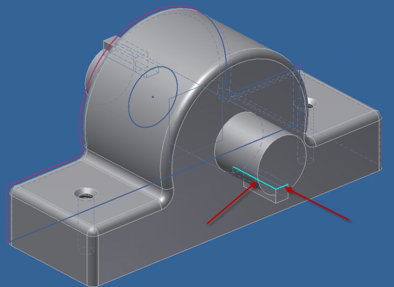

RichardAlbert Posted September 14, 2011 Posted September 14, 2011 Hello everyone, I hope I am not doing something bad by posting in here....I read a ton of threads and nothing seems to help me out. I have a very simple animation which consists of a pillow block holding a shaft that sticks out 1 inch on each side. I have been trying to get this to work for DAYS now and I am getting very frustrated cause I dont know what I am doing wrong. I have assembled my shaft and pillow block correctly and managed to animate it (10 Revolutions in 20 seconds) I was also able to add a pin on one side of the shaft to lock into a pin or a connecting rod at some future point and the animation still works fine. My problem is when I try to add a lock pin to the other side of the shaft for some reason I can easily manipulate it in Assembly mode with my mouse but as soon as I try to run the animation on it with the constraints it stops working. If I suppress the constraints for the second lock pin, the animations starts working again. I dont know what im doing wrong.....please for the love of god someone help me. I am attaching a zip file with all three parts and the assembly file. I realize this is probably a real newbie problem but I am in the process of learning. I LOVE inventor. All I need now is to fully understand animations and why the heck everything goes wrong as soon as I have two parts constrained to my shaft. Thank you so much for your time and I hope this doesn't **** anyone off. Richard Simple.zipFetching info... Quote

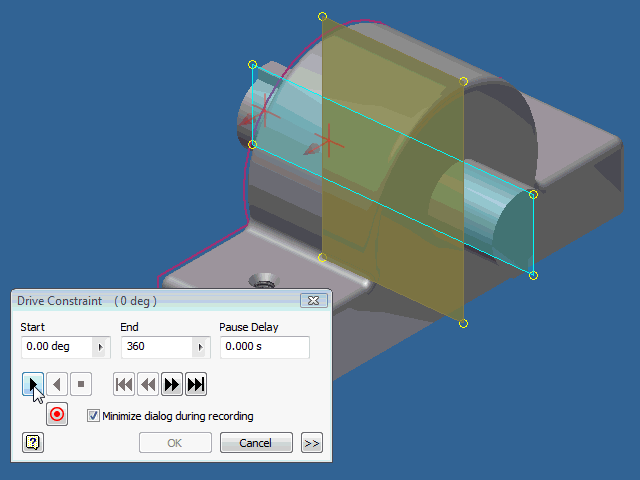

RichardAlbert Posted October 1, 2011 Author Posted October 1, 2011 Hi me, since nobody else can help you with this i will take a shot at it. You have to create an angle constraint between the lock of the shaft and the base of the pillow block and then just animate that constraint by however many degrees you want. Sorry it took me so long to reply. Future self. Quote

kencaz Posted October 1, 2011 Posted October 1, 2011 Well, you only need two constraints to mate the King Pin to the shaft...: For the animation best to Drive an angle constraint between the Shaft plane and the Pillow Block Plane... Good Luck KC Quote

JD Mather Posted October 2, 2011 Posted October 2, 2011 Not many people are still using Inventor 2008 and the files (from 2012) are not backward compatible. Students can download Inventor 2012 for free from http://www.autodesk.com/edcommunity I noticed that in your Pillow Block part that Sketch1 is not constrained - you might start by reading this document http://home.pct.edu/~jmather/AU2006/MA13-3%20Mather.pdf also, you drilled 1/4 holes for 1/-20 holes. This huge huge huge mistake - there is no material for the threads. Use the thread tool within the Hole command rather than add thread afterward - Inventor will select the correct tap-drill size for you. For Belts with pulleys - use the Design Accelerator within the assembly environment. Quote
