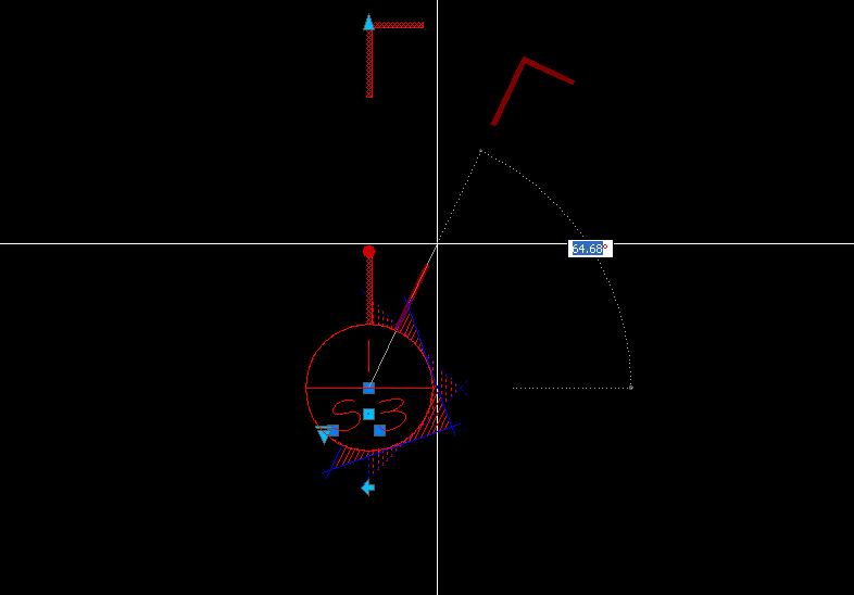

qball Posted September 13, 2011 Posted September 13, 2011 what have you got so far? draw your circle and arrow using any pline or line you like. Then use ATTDEF to insert your attributes. I would use tags like SECTION, SHEET (and DISCIPLINE if it varies from Mechanical to Structural to Architectural or whatever). I also recommend making it a dynamic block with rotation, stretch and visibility parameters. You can rotate the arrow and tail, stretch the tail, and hide the tail and the arrow as well. And when you upgrade to 2010 or newer make it Annotative. oh and if you need the section head at each end you can use Fields so they match. Quote

qball Posted September 13, 2011 Posted September 13, 2011 I like this woman's tutorials: http://www.ellenfinkelstein.com/acadblog/dynamic-blocks-tutorial/ basically, make your section mark with all the linework and text attributes first. Best to have all your objects completed before getting into the Dynamic stuff. Then open the block in Block Editor BEDIT command. You will see a little Palette open up . I think A2010 has one called Parameter Sets. Select "Rotation Set" and follow the prompts on the command line. Once the command is complete you still have to pick what you want to rotate. Right click the little icon that should have a yellow triangle exclamation point on it, pick Action Selection Set, Modify Selection Set, select the arrow and tail, but not the attributes (text). Then, try it out. I think on the Ribbon under the Open / Save tab there is a Test Block button. Quote

ReMark Posted September 14, 2011 Posted September 14, 2011 Toool Palettes > Annotation tab > Section Callout is the symbol I think you are looking for. It's one of the sample dynamic blocks that ships with generic AutoCAD. Quote
