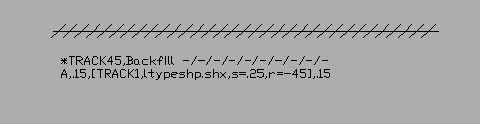

I am trying to make a variation of the track linetype in CAD but when I save it I keep getting bad definition when I try to load. The code I am using is below.
*TRACKS2,Tracks2 -/-/-/-/-/-/-/-/-/-/-/-/-/-/-/-/-/-/-/-/-/-/-/-/-
A,.15,[TRACK2,ltypeshp.shx,s=.25],.15
I just want the same as the track line type but with the vertical dash at 45 degrees.
Can anyone enlighten me and tell me where I am going wrong.
Thanks a million
Sooz
Have you altered the file ltypeshp.shx to include the shape TRACK2?
As the shape TRACK1 is already in that file, I would look at rotating it with the r factor and possibly adjusting the point of insertion using the x and y factors, and even scaling it with the s factor to give your new linetype.

But if you go back to your original try, you only had to add r=-45 to the existing tracks linetype to get what you wanted.

I have the linetype working based on your suggestion Eldon and my old issue now is that the dashes only appear to be at about 1 degree rather than the 45. The code now looks like this:
*track45,Backfill ---/---/---/---/---/---/---/---/---/---/---/---/---/---/---/---
A,2,[track1,ltypeshp.shx,s=.25,r=-.45],.5
Could this be due to another setting within my drawing?
Thanks in advance.

I was going to say that the r factor is the rotation in degrees. One way is positive and the other way is negative (I tried both before I saw which way was which).
So your rotation was only 0.45 degrees which is nearly one degree.
So try this
A,2,[track1,ltypeshp.shx,s=.25,r=-45],.5

Thanks Both. I realise not that I must have not reloaded the linetype properly when I updated it. It is working fine now. Thanks so much for all the help.
