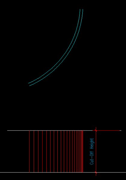

Hi All,
I have been trying to write a routine that would project a curved wall to the elevation, based on the number of segments the user would input.
So far I could figure out how to get points along the arc based on the number of segments. Now I want to project it to a selected line as shown in the picture. The code now draws the radiating lines to the points on the arc.
I am stuck here. Now I dont know how to draw perpendiculars to the line from these points. In fact I dont know how to figure out the angle at which these lines should be projected.
In the picture, they are simple, the lines could be projected to an angle of 270 degrees. But what is the line lies on top of the arc; or at right side of the arc at an angle of 10 degrees? This is where I am stuck Could someone guide me to find out the projection angle of the lines from each 'P2's (the points along the arc)? Here is my code...

Something like this?

(defun c:ProjectCurve (/ crv l1 l2 div pt1 pt2 pt3 n l1s l1e ang l2s l2e)
 (if (and (setq crv (entsel "\nPick curve: "))
          (setq crv (car crv))
          (setq l1 (entsel "\nPick furthest projection line: "))
          (setq l1 (entget (car l1)))
          (setq l1s (cdr (assoc 10 l1)))
          (setq l1e (cdr (assoc 11 l1)))
          (setq ang (+ (angle l1s l1e) (/ pi 2.0)))
          (setq l2 (entsel "\nPick nearest projection line: "))
          (setq l2 (entget (car l2)))
          (setq l2s (cdr (assoc 10 l2)))
          (setq l2e (cdr (assoc 11 l2)))
          (setq div (getdist "\nSelect maximum curvature arc length per projection line: "))
     (setq n   (vlax-curve-getDistAtParam crv (vlax-curve-getEndParam crv))
           div (/ n (1+ (fix (/ n div))))
     (while (> n 0.0)
       (setq pt1 (vlax-curve-getPointAtDist crv n)
             pt2 (inters l1s l1e pt1 (polar pt1 ang 1000.0) nil)
             pt3 (inters l2s l2e pt1 (polar pt1 ang 1000.0) nil)
       (entmake (list '(0 . "LINE")
                      (cons 8 (getvar 'CLayer))
                      (cons 410 (getvar 'CTab))
                      (cons 10 pt2)
                      (cons 11 pt3)
       (setq n (- n div))
Not enough error checking but at least it works. Even "works" on pl arcs, though for those there should be a bit of different programming to make it work on segment endpoints as well.
Wow...!!! Thats Great...!!! Thanks a lot for that code, IRNEB...!! :D:D:D:D
You're welcome. I wasn't sure if you wanted the divisions by a specified number or rather as per my code (a maximum source distance). It would be a small change to asking the user to enter the number of divisions instead, actually the math would also be a bit simpler.
Well... that will work...
And I asked for 1 kg of iron and received 1 kg of gold...!!! HE HE.. :D
Why because, my code would have worked only for arc objects. This works on anything...!!!
Thanks...!!
Also I got a lot new things from your code to learn...!!! Happy Happy.... :)
Yep! Glad to help you learn :thumbsup:. It's how I learnt most of what I know: examples & doing it for myself from there.
Mainly the vlax-curve functions is what makes my code a lot easier than it would be otherwise. Then it's the usual obtaining an angle, rotating by half-pi (90 degrees) then getting intersections by using inters & polar. That last part allows the projection to be at any angle as well, it projects perpendicular to the furthest projection plane. So your 2 planes may even be non-parallel and at any angle.
