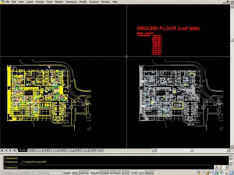

Friends my problems is that.....
My autocad toolbar are not showing......
I have checked ctrl+0 option.......
But this is not working
and my toolbar are not showing
plz.........help me
thanks advance..............8)
dink that was the picture of cad file
i have used ctrl+0.
so...if you do ctrl+0 again, it doesn't get back?
MR. this is constant condition it is not changing............
Start with getting the STANDARD toolbar to show then once you do you can right-click on it and retrieve all the toolbars you lost.
Command: -TOOLBAR
Enter toolbar name or [ALL]: Standard
Enter an option [show/Hide/Left/Right/Top/Bottom/Float] : Show
thanks ReMark..............................

You have it fixed now, right?
I was going to ask if you were using the Numeric Keypad, or the numbers along the top, and suggest CleanScreenOFF
Yes nestly i fixed it......
And i checked that one option clean screen on "or" clean screen off
ctrl+0 but it did not work.........
And i fixed that -toolbar option
