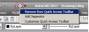

That appears to be the Quick Access Toolbar. What options do you have if you right-click on the button?

I have no the item Remove from Quick Access Toolbar:

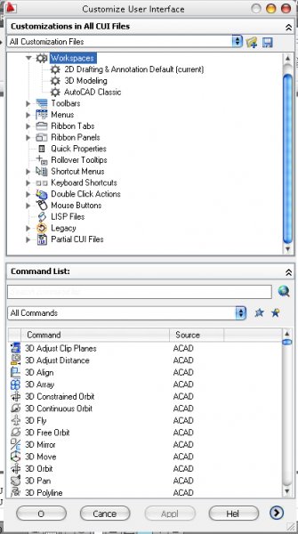

I selected Customize Quick Access Toolbar, hoping that I will be able to manage the Quick Access Toolbar buttons, but here is what I saw after:

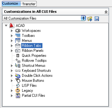

I also tried the method suggested by Lee Mac, but I didn't find the Quick Access Toolbar tree branch:
What's wrong? I'd like to remind that I have AutoCAD 2009.

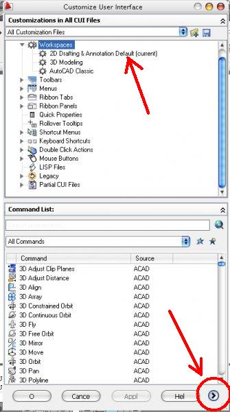

Expand the CUI with the arrow button at the bottom right of the CUI dialog, select a workspace, and you should see the Quick Access Toolbar in the top right pane.
Also, with the CUI open, you may just be able to drag or right-click drag the unwanted button back down to the CUI command list pane.
