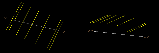

i've searched for a while, but cannot find out how to:
3D-polyline Intersection.gifPick two points running across your 3D Topo (3D Polylines)
and the above will create a 3D Polyline with vertices at
the elevations (Z) of the crossed 3D Polylines.
sorry for my bad english (i speak dutch)
Many thanks
Pascal
3D polyline Sample.dwg
Pascal,
That could be a very intense project.
Questions:
  • are the yellow line always a 2 point 3DPOLYline?
  • are the yellow lines always parallel?
  • is the intersecting line always a 2 point vector
Just for a few for starters -David

David,
are the yellow line always a 2 point 3DPOLYline? No
are the yellow lines always parallel? No
is the intersecting line always a 2 point vector Yes

In plain Autolisp:
(defun c:slice3dp (/ p1 p2 vl ss en ed vn vd vl il sl tp zp al md d2d i)
(defun FindZOnLine (fp p1 p2)

I'm sure some of this could be condensed. -David
David ,
It works perfect. You did a great job and thanks.
It will save me a lot of time with this task that I have to do.
thx for your time.:D

Having had a proper look, I must say, great code David, I really like your method: clean and intuitive to follow.
I hope you don't mind, I have made some modifications to condense the code and perhaps improve performance:

Another way ....... :)
Tharwat,
I don't think you have understood the task - it is impossible that the result could be an LWPolyline since the elevation will need to vary along the length of the contour. Try your code on the drawing provided by the OP.
Result using David's code:
Result using Tharwat's code:
