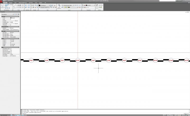

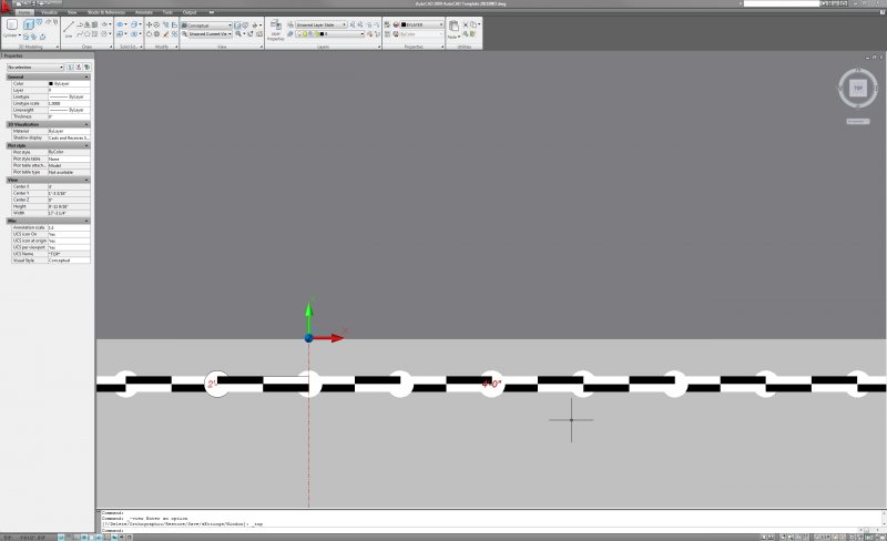

Here are a pair of screenshots. I didn't play with it enough to try to get it to misbehave in 2D wireframe again, but as you can see when I go from a 2D Wireframe to a conceptual view all sorts of weird things start to happen.
Matt
odd. I don't know what to do. It might be annoying, but if you're not printing Conceptual View then it shouldn't be a problem.
That is wierd but there are fixes.
You gould give the circles and text a positive z value, like 0.01 and leave the bar at 0.00.
Also, is regenauto on? It almost sounds like a regen issue.
or:
Copy the circles and text to a new location. Delete the old circles and numbers (P for previous). Then move the new circles and text back into place. I use that one often.
The Draworder command works, but sometimes does wierd things. Take wipeouts for instance. They'll make ya crazy. AutoCAD's database (your drawing) is 'first in, first out'. So the last entity created will be the last item drawn, on top of everything else. Draworder doesn't delete the old and make new, it just puts a 'plot last' tag on the item.
