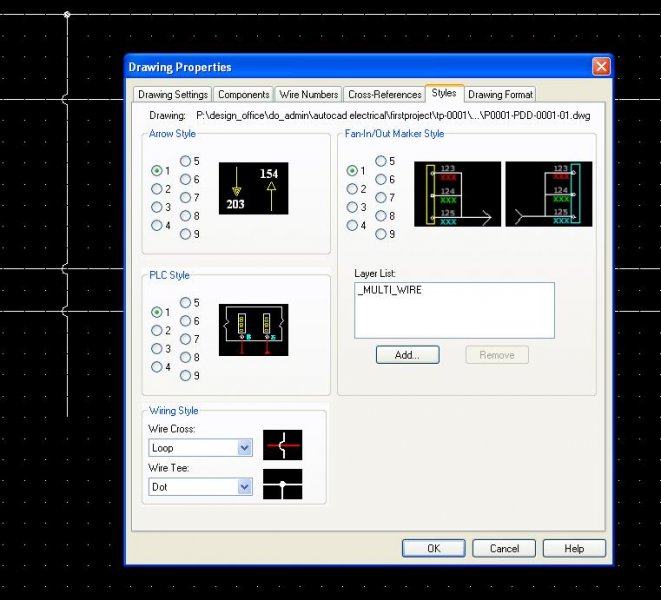

sachin Posted September 7, 2011 Posted September 7, 2011 hello can any one tell me how to draw the intersection wire like a half circle passing over the other wire. Regards sachin Quote
dbroada Posted September 7, 2011 Posted September 7, 2011 if you are using electrical it is in the Drawing Properties tool under Styles. If not, you have to do it by hand or get a LISP written. Quote
sachin Posted September 7, 2011 Author Posted September 7, 2011 hello dbroada yes i m using 2008 electrical autocad. i manage to get styles but it showing me text, dimension, table and multileader style. May be i am wrong. can u tell me how do u go to styles and then draw the intersection wire. i tried to draw by hand but its not perfect. Regards sachin Quote

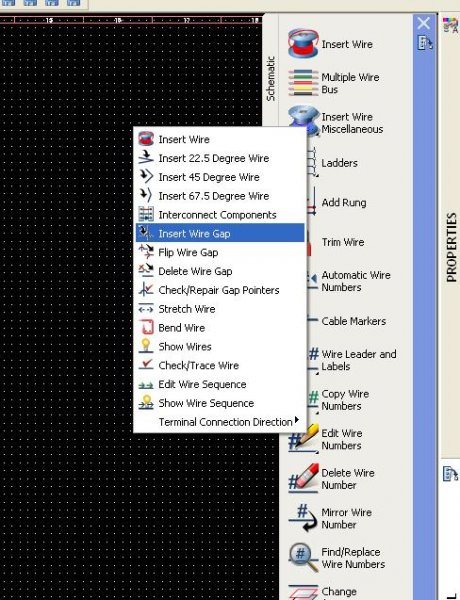

ReMark Posted September 7, 2011 Posted September 7, 2011 Your terminology is incorrect. It is not referred to as an intersection wire in AutoCAD Electrical. It is called a wire gap (i.e. - where one wire crosses over another). The gap is usually created automatically. It can be set manually as well. Using the Ribbon: Schematic > Insert Wires/Wire Numbers > Wire > Gap. Quote
ReMark Posted September 7, 2011 Posted September 7, 2011 Lisp is a programming language. Lisp routines are small programs that run inside AutoCAD. There are custom lisp programs that can be used to create the semi-circle that is used to denote one line crossing over the other. A good routine will insert the circle and trim away any unnecessary linework with some input from the user. Quote
sachin Posted September 7, 2011 Author Posted September 7, 2011 sorry for so many silly question, but i m new at autocad no i m not using ribbon. how can it be usefull and how do i get it? Quote
ReMark Posted September 7, 2011 Posted September 7, 2011 OK, I thought the Ribbon was available in Electrical 2008. Guess I was mistaken. From the command line type AEWIREGAP. Tell me if that works. BTW...it is the crossing wire that receives the semi-circle (wire gap). Quote
sachin Posted September 7, 2011 Author Posted September 7, 2011 NO, When i type AEWIREGAP, screen says press F1 for help. Also in help i am not able to get the answer. Quote

dbroada Posted September 7, 2011 Posted September 7, 2011 I will post a screenshot tomorrow (if I remember) to show how it is set. We NEVER draw crossings that way and only show intersections (with a blob). Quote

dbroada Posted September 8, 2011 Posted September 8, 2011 (edited) to set the loop type crossing open your drawing and select drawing properties from the electrical wires palette. Alternatively the WD_DWG_CONFIG should get you to the same place. Under the style tab you have the option of crosssing, break & loop. Once set, any new wires will have the loops added. To go back to a crossing type you can select the wire and right click to get the remove breaks option. I can't remember the corrct way to add loops to an existing wire but if you scoot the wire the loops will be added. ReMark, loops are only a suggestion in BS and we have some project managers who like to see them - until they realise just how much extra we charge for modifying the drawings at which point they are usually happy with crossings. Edited September 8, 2011 by dbroada remembered WIREs get loops, not LINEs. Quote
ReMark Posted September 8, 2011 Posted September 8, 2011 Dave: Thanks for the image and the explanation. Quote

dbroada Posted September 8, 2011 Posted September 8, 2011 I know we have moved on but for the sake of completness following on from ReMark's post #6. In 2008 electrical (prior to the ribbon) the wire gaps can be added from the WIRE palette under wire miscellaneous. Quote
