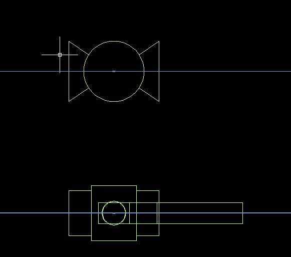

blackeagle1245 Posted September 9, 2011 Author Share Posted September 9, 2011 what is the problem if its schematic then nothing happens? what is special about it? If you're in Plan View then it's probably an Annotative problem. The MvPart has 2D Annotative blocks for each "View", including Top, Bottom, Left, Right, Front and Back Views. This might be the first place I would look. Also check your Display Manager to see if the current Display Configuration has MvParts set as Schematic. If so then this is definitely the problem. Quote Link to comment Share on other sites More sharing options...
tzframpton Posted September 9, 2011 Share Posted September 9, 2011 Are you wanting the MvPart to be the Schematic symbol or do you want the actual MvPart to show the default 3D part? Quote Link to comment Share on other sites More sharing options...
blackeagle1245 Posted September 9, 2011 Author Share Posted September 9, 2011 ok I did it. but now I have a second issue. Now the vane look like how I want but pipe goes inside the vane. Quote Link to comment Share on other sites More sharing options...
tzframpton Posted September 9, 2011 Share Posted September 9, 2011 I'm not understanding vane. Are you talking about vanes in duct fittings? Can you post an example? Quote Link to comment Share on other sites More sharing options...
blackeagle1245 Posted September 9, 2011 Author Share Posted September 9, 2011 yes I put just a ball valve on to a pipe sorry for vane I just used the wrong word. Here is an example. As seen in the picture pipe seems to goes inside in a valve cause it gets 100 time bigger then normal. Quote Link to comment Share on other sites More sharing options...
tzframpton Posted September 9, 2011 Share Posted September 9, 2011 That's just because the symbol is extremely enlarged. Quote Link to comment Share on other sites More sharing options...
blackeagle1245 Posted September 11, 2011 Author Share Posted September 11, 2011 so no more solution for this? Quote Link to comment Share on other sites More sharing options...
tzframpton Posted September 12, 2011 Share Posted September 12, 2011 The solution is to readjust the scale override. Quote Link to comment Share on other sites More sharing options...
blackeagle1245 Posted September 12, 2011 Author Share Posted September 12, 2011 still even I readjust it still gets into it a little bit. Quote Link to comment Share on other sites More sharing options...
tzframpton Posted September 12, 2011 Share Posted September 12, 2011 Yes, it will, it's a limitation of the program. But a little bit should hurt your plan view drawings, should it? If so then I don't know how else to approach the issue, other than trying out Revit MEP instead. Quote Link to comment Share on other sites More sharing options...

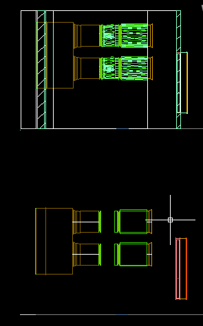

blackeagle1245 Posted September 16, 2011 Author Share Posted September 16, 2011 I'm taking a section from a garage fan but It seems like this on the top. when I change display style then the second one fan dissappears. Quote Link to comment Share on other sites More sharing options...
