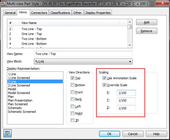

blackeagle1245 Posted September 7, 2011 Author Posted September 7, 2011 I need an advice I'm stucked in a situation. My mvparts,vanes etc. seems in 1/1 scale. But When I print out them 1/100 scale, I cant even see them. They look very small. What do you do when you print out your drawing?. I dont know what to do I know I cant scale mvparts. Quote
tzframpton Posted September 7, 2011 Posted September 7, 2011 If you're in Plan View then it's probably an Annotative problem. The MvPart has 2D Annotative blocks for each "View", including Top, Bottom, Left, Right, Front and Back Views. This might be the first place I would look. Also check your Display Manager to see if the current Display Configuration has MvParts set as Schematic. If so then this is definitely the problem. Quote

tzframpton Posted September 9, 2011 Posted September 9, 2011 It would be better if I saw your example instead. Upload the file or link it in some way if you can and I'll take a look at it. And I always plot from Sheets, never from Views or Constructs/Elements. Quote
blackeagle1245 Posted September 9, 2011 Author Posted September 9, 2011 ok I'll start using sheets instead of constructs or so but I tried from sheets still samething occurs I'm sending small part of my drawings to check vane sizes. I cant change the scale. example.dwg Quote
tzframpton Posted September 9, 2011 Posted September 9, 2011 Right click the MvPart, click "Edit MvPart Style". Under View tab in the Scaling options, check both the "Use Annotation Scale" and "Override Scale". In the three Override Scale boxes, type in 1/100 in each box. It'll show as zero but don't worry, it will take the input just fine. Click OK and it should be just fine. If you need it to be bigger or smaller, then adjust the 1/100 to whatever scaling factor fits your needs. Quote
blackeagle1245 Posted September 9, 2011 Author Posted September 9, 2011 thank you very much but normally the mep's original mvparts should be selected like this or do I need to select use annotation scale to all of them? Quote
