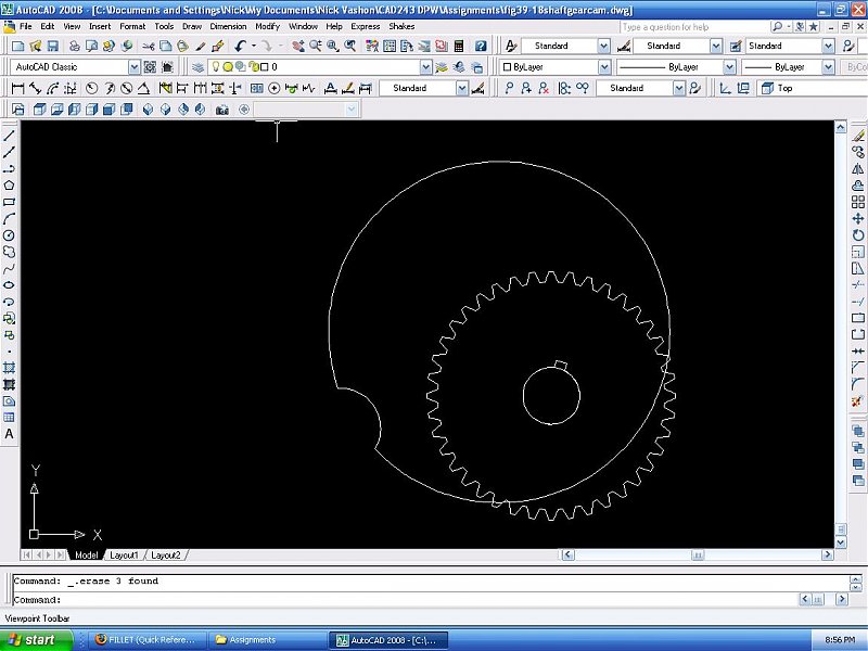

Is there an easy way to change the shape of a circle? There are only four grips on the circle when selected. Is there a way to make more so that I have many areas to pull from and change the shape of the circle. I want to take an ordinary circle and put a small dent in it.
Thanks for any suggestions.

is this a regular or random 'dent'?
if it has a definition, you could for instance, draw a CIRCLE or ARC to describe the dent, then use a FILLET to smooth it into your circle
For some reason I can't get fillet to work on this. I've tried many different sizes for the fillet radius but I still cannot see the fillet.
Thanks
nick
Don't know what I was doing wrong before but it seems to work fine now.
It must have been because I used the pedit command on the circle. Once it was exploded it worked fine.
