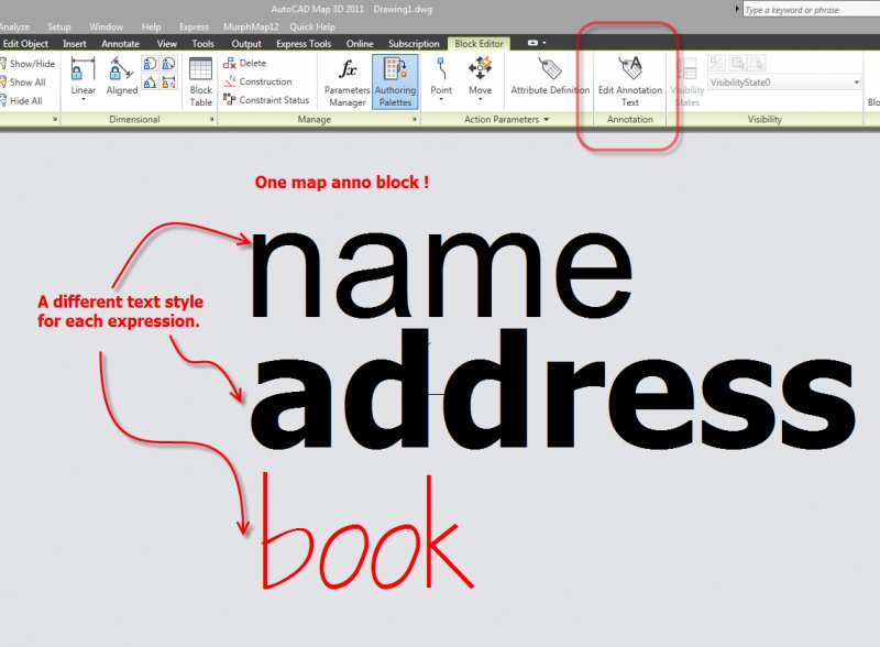

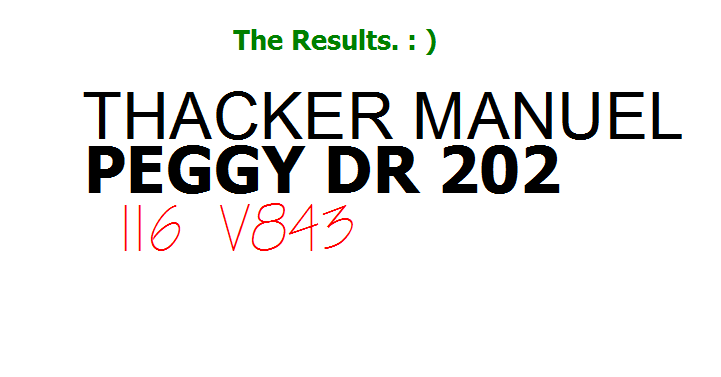

Murph_map Posted September 7, 2011 Posted September 7, 2011 The expression to put them all on one line with be like this (strcat :vrt@terenrui " " :clp@terenrui) that will put the vrt value a space then clp value all on one line. Now if you want sepertate text style for each you can create 3 different attributtes (mapanntext objects) in the same annotation block and assign each one a different AutoCAD text style and color. Quote

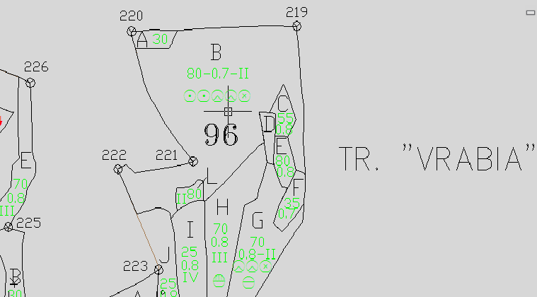

constantin Posted September 8, 2011 Author Posted September 8, 2011 The problem is that this is a block(or it is not a problem????), if i want to edit that text i can not, i can just delete or add some characters. Examle: Like block it looks so: 100-0.8-II Then i arrange this text according to the polygon surface(right on the map) i need to edit it like this: 100 0.8 II Quote
Murph_map Posted September 8, 2011 Posted September 8, 2011 constantin said: The problem is that this is a block(or it is not a problem????), if i want to edit that text i can not, i can just delete or add some characters.Examle: Like block it looks so: 100-0.8-II Then i arrange this text according to the polygon surface(right on the map) i need to edit it like this: 100 0.8 II The block is tied to the OD table if you need to edit the vaules edit the table not the block, then refresh the annoblocks and the data updates. If you need seperate lines then use another mapannotext object in the same block. There's no rule that says you can use only one attributte in the block. Quote

constantin Posted September 9, 2011 Author Posted September 9, 2011 this is how it should look like. Quote
