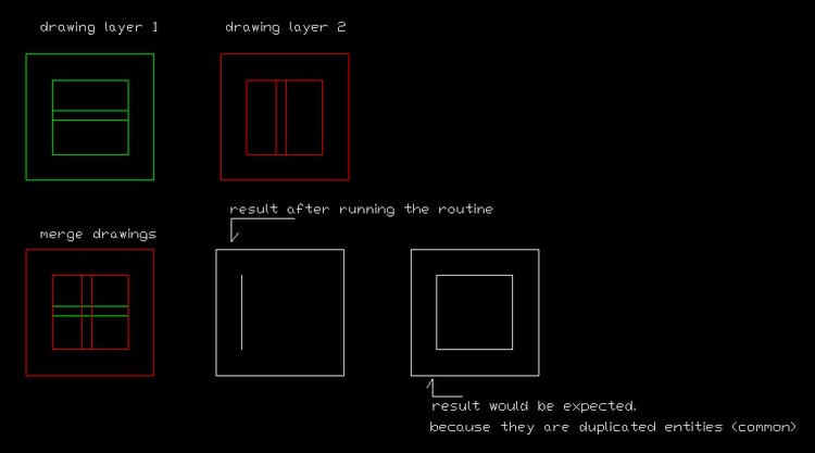

teknomatika Posted September 6, 2011 Author Posted September 6, 2011 pBe, Any color. is indifferent. However I tried the new version of the routine. It seems to be better. But still some inconsistencies. I attach an image to better understand. The result after running the routine is not consistent: Sometimes doing the work properly and sometimes not. Strange. Quote
pBe Posted September 6, 2011 Posted September 6, 2011 pBe,However I tried the new version of the routine. It seems to be better. But still some inconsistencies. I suspect the inner square are different entities.. one is PLINE the other are lines or the other three are not exact geometrically the same Quote
teknomatika Posted September 6, 2011 Author Posted September 6, 2011 No. If no polylines. The polylines of the rectangles were previously exploded. In most cases the routine performs the task well. It's almost perfect. Quote
pBe Posted September 6, 2011 Posted September 6, 2011 (edited) No. If no polylines. The polylines of the rectangles were previously exploded.In most cases the routine performs the task well. It's almost perfect. Strange indeed Anyhoo. what do you want to do with the colors? POST UPDATED: includes color retention for new duplicate layer Edited September 6, 2011 by pBe Quote

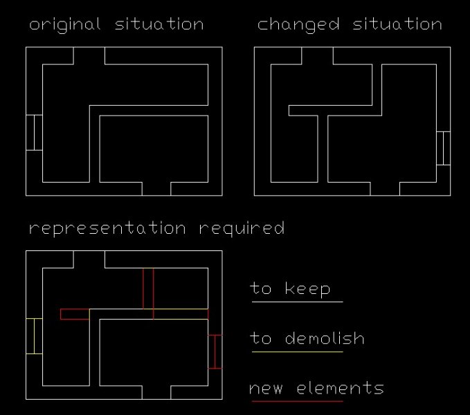

teknomatika Posted September 6, 2011 Author Posted September 6, 2011 It really begs the question...How does one end up with so many duplicate entities that a lisp routine is needed to cull them out then transfer them to another layer? What's the purpose of putting them on another layer instead of deleting them? ReMark, In my work, when the building project is subject to change, for the purpose of the licensing department works, you must present the drawings of the building with a certain graphic description: The unchanged elements are represented in white (black). to demolish the elements are represented in yellow and the new elements will be represented in red. With this routine, I intend to simplify the process of comparing the existing situation and the situation changed. In the drawings overlapping entities correspond to duplicate existing elements unchanged. Quote

teknomatika Posted September 6, 2011 Author Posted September 6, 2011 ReMark, an example with an image: (the yellow is a little pale). Quote

teknomatika Posted September 6, 2011 Author Posted September 6, 2011 Couldn't you just copy to a new layer the objects that you needed to retain and then turn that layer on/off in your viewport to get the affect you are looking for? ReMark, My problem is not so much in the preview. This type of work has to be printed. For this to result in the plotter I have to have three different situations in three different colors. As I have been explaining, the routine only will allow to be detected and isolated entities considered duplicates or common so that a second phase of work to assemble the three separate components. Quote
teknomatika Posted September 6, 2011 Author Posted September 6, 2011 So you are already using different layers with different colors to begin with. Wouldn't areas to be demolished be cross-hatch in some manner? Are you familiar with Format > Layer Tools > Copy objects to new layers command? What about using lineweight to distinguish between existing and proposed structures? Yes, I know this tool and these options. This is the procedure I use. However, for complex designs that will not work because it results in a time consuming task. With the routine the whole process is automated and therefore much faster. Quote
