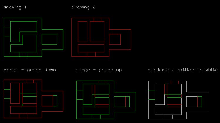

So you are looking for a utility that will move all duplicate entities to another layer rather than delete them, right?
ReMark, Yes, that's it.
I want to take duplicate entities, to give them a specific use.
depending on what you mean by 'entity' you might be able to accomplish this through the filter command
Daniel:Any and all AutoCAD entities: lines, polylines, arcs, circles, points, text, etc..
For what I want, it would be good to consider at least the lines.
With the command filter, do not seem to select only those entities duplicate.
This would be require a comparison routine using lists, a lot of list, but i think its doable
It gives me headache just by thinking about it :)
What about this approach
limited testing..

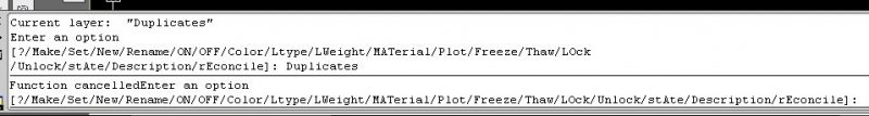

Dear friends: It certainly is a routine that could be improved, but for now is to solve what I wanted.
However, in certain situations, does not seem to work. After calling the routine and selected entities, the layer "duplicates" is created but it gives an error function. Annex clip of the message.
I forgot to tell: In this error condition, the layer is created but duplicate entities are not detected.
What is the reason?
Strange.. the code is not even supposed to invoke the Layer command. whee did that come from?
EDIT: I see now, it gives that error if none found :lol: (the code doesnt include much errorr trapping in testing phase) perhaps enitites on locked layer?

(defun c:test  (/ lvn objs entN ent OrgEnt ObjColl a Entcoll LstR dupobj ln nl ln)
     (vl-load-com)
     [color=blue](setq objs (ssget ":L" '((0 . "~VIEWPORT") (0 . "~INSERT")(8 . "~*_D"))))[/color]
     (repeat [color=blue](sslength objs)[/color]
           (setq entN [color=blue](ssname objs 0))[/color]
           (setq OrgEnt (cons entN OrgEnt))
           (setq ent (entget entN))
           (foreach
                  itm
                     '[color=blue](-1 5 8 62 6)[/color]
                 (setq ent (vl-remove (assoc (eval itm) ent) ent)))
           (setq ObjColl (cons ent ObjColl)
                 EntColl (cons (list ent entN) Entcoll))
           (ssdel entN objs))
     (while (setq a (car ObjColl))
  [color=blue](if ( member a (cdr ObjColl))[/color]
[color=blue]                     (progn[/color]
[color=blue]             (setq ObjColl (vl-remove a (cdr ObjColl)))[/color]
[color=blue]                       (setq dupobj (entget (car (member[/color]
[color=blue]                                                   (setq LstR (cadr (assoc a  entcoll)))[/color]
[color=blue]                                                   OrgEnt))))[/color]
[color=blue]                       (entmod (subst (cons 8 (setq NL (strcat (cdr[/color]
[color=blue]                                                                     (setq ln (assoc 8 dupobj))) "_D")))[/color]
[color=blue]                                   (assoc 8 dupobj)  dupobj))[/color]
[color=blue]                       (if (not (member NL lvn))[/color]
[color=blue]                             (vla-put-color (vlax-ename->vla-object (tblobjname "LAYER" NL))[/color]
[color=blue]                                  (cdr (assoc 62 (tblsearch "LAYER" (cdr ln)))))[/color]
[color=blue]                                     (setq lvn (cons NL lvn))))[/color]
[color=blue]                       )[/color]
                (setq ObjColl (cdr ObjColl)))
                  (prompt "\r\\")
           (princ LstR)
           (prompt "\t......Evaluating....please wait.. ")
Warning: Adverse effect on Anotative TEXT/MTEXT
Edited by pBe
pBe,
With the update is happening the following: The routine detects and locates in its own layer duplicate entities, but entities existing in the global design and that are not duplicated. Another definition for duplicate entities that I consider is the fact that they are overlapping each other. These are but overlapping entities duplicate what I intend to be differentiated.
On the other hand, the routine operates on the entire design. I intend to do so only in relation to elements within a selection.
Attached with a picture for better understanding.
Basically, I have two drawings with each other which have different geometric entities and equals geometric entities.
When I overlap the two drawings, I want the routine to select and isolate layer itself, these common entities (duplicate).
Hence the statement
"Problem I can see with that is, which one the two will be moved to "Duplicates" layer?"
How'd you propose to go about doing that?
We could include a prompt to select an entity for layer information and retain enitities on that layer. and the rest would be moved to a new layer with the its original name with a suffix of _D?
Would that work for you?
