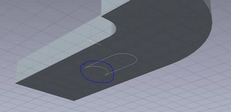

Hi everyone,
I just do not understand a simple thing (Sorry for resurrecting the topic btw).
I just need to draw two arcs, connect with two lines and subtract (extruded cut) the generated shape from a 3D solid I already drew. Here is my solid.
I don't know how to write arc command.
(command "arc" ........
What should I write for the rest? Variables? Center point? Start point?
Is there any reference book you can suggest that shows how to use AutoCAD commands by AutoLISP?
I always have trouble AutoCAD commands like (command "something" ......)
Thanks for bearing with my dumb questions.
Hi everyone,
When trying to replicate a native command, the easiest thing is to step through the command and fill in appropriate data, based on prompts.
eg.
Command: a ARC
Specify start point of arc or
Specify second point of arc or [Center/End]: e
Specify end point of arc:
Specify center point of arc (hold Ctrl to switch direction) or [Angle/Direction/Radius]: r
Specify radius of arc (hold Ctrl to switch direction): 50
would translate to
(if (and (setq p1 (getpoint "\nSpecify first point: "))
        (setq p2 (getpoint "\nSpecify end point: "))
        (setq rad (getreal "\nSpecify radius: "))
 (command "_.arc" "_non" p1 "_e" "_non" p2 "_radius" rad)
The "_non" should always precede a point call so as to ignore any running osnaps.

ANYTIME a point would be specified, precede with "_non".
Thank you sir, your suggestions helped me a lot.
But, I don't know how to change the direction of the arc. Please see the picture. I need the arc in other direction.
