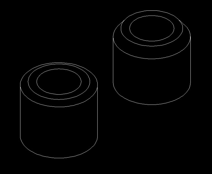

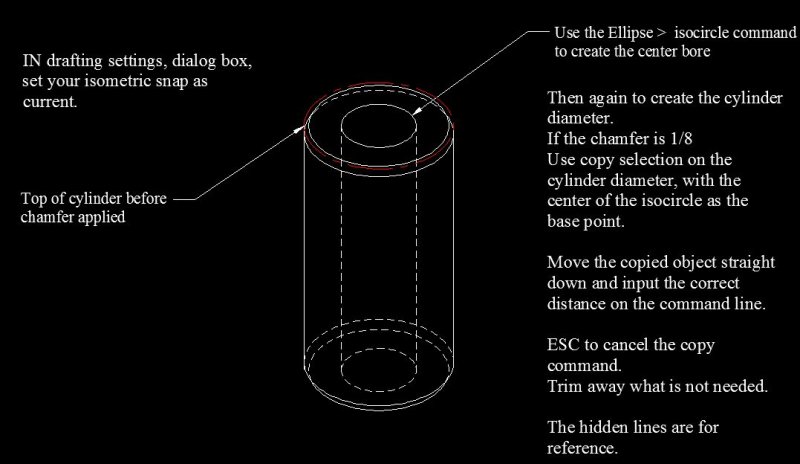

rkent Posted August 31, 2011 Posted August 31, 2011 Assuming you mean chamfer a cylinder, draw the smaller circle at the center of the larger one, then move the larger circle down by the proper amount, trim if needed, etc. Quote

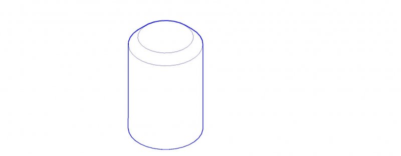

ReMark Posted September 1, 2011 Posted September 1, 2011 An example of a cylinder with a chamfer. It was done in 3D and the visual style set to Hidden. Quote

ReMark Posted September 1, 2011 Posted September 1, 2011 I guess I also should have noted that I used a SE isometric view for my cylinder in post #7. Quote

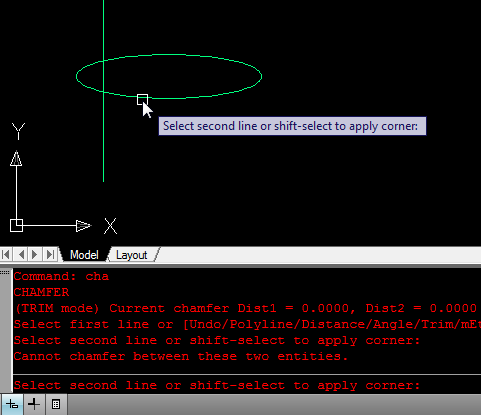

BlackBox Posted September 2, 2011 Posted September 2, 2011 Tony, FWIW - some may interpret the *tone* of your last post as being impatient, and/or rude. Typically when someone *talks* that way, I choose to respond by asking them to tell *us* what happens when they attempt this themselves. Not knowing for sure, I am willing to give you the benefit of the doubt. Now, perhaps this will help to clarify: Command: cha CHAMFER (TRIM mode) Current chamfer Dist1 = 0.0000, Dist2 = 0.0000 Select first line or [undo/Polyline/Distance/Angle/Trim/mEthod/Multiple]: [color=blue]<SelectsLine>[/color] Select second line or shift-select to apply corner: [color=blue]<SelectsEllipse>[/color] [color=red]Cannot chamfer between these two entities.[/color] By definition a circle is not an ellipses, nor a cylinder, sphere, or the like. Perhaps a little more acuracy in the question's wording, or even a sample drawing being posted will yield the desired result more quickly in the future. HTH Quote
