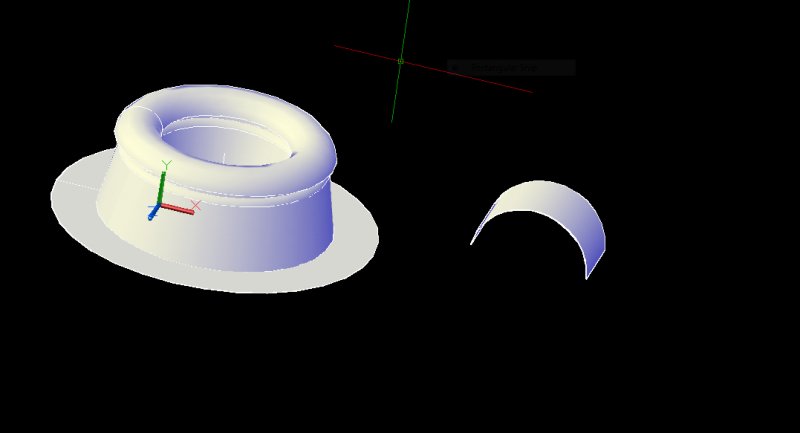

bjenk8100 Posted August 31, 2011 Posted August 31, 2011 im still trying to figure this out so i figured id post it and see if someone can help while i work on it. im am trying to draw a roof vent cap in 3d. So far, I drew an arc and revolved 360 deg but it leaves a hole in the middle of the solid. Then i extruded it and got the top profile correct but i need the bottom to follow the curve and not fill it completely in. Help is greatly appreciative\. Quote
bjenk8100 Posted August 31, 2011 Author Posted August 31, 2011 i extruded it and got the correct profile but not revolved. here is a pic. Quote
JD Mather Posted August 31, 2011 Posted August 31, 2011 Sounds like you should Revolve about a line from one end of the arc to other (or pick two points) and then thicken the surface body to a solid. Quote

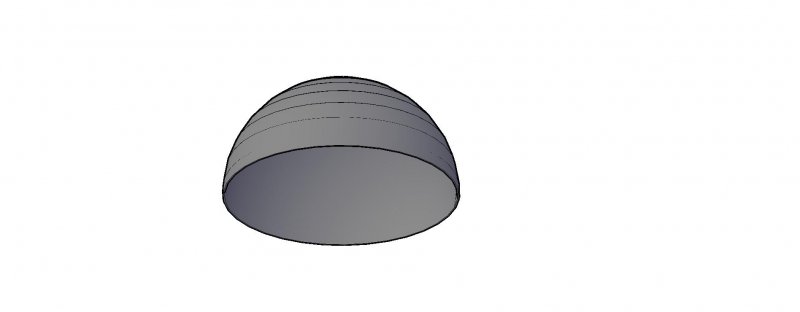

ReMark Posted August 31, 2011 Posted August 31, 2011 And I assumed you wanted the dome to cover the top of the vent pipe. Maybe have a couple of straps attaching the two? A dome could be created with an arc and revolved 360 deg. Quote
bjenk8100 Posted August 31, 2011 Author Posted August 31, 2011 i dont think revolve is the right method. this is tough. as remark said i need a dome. it should be a difficult thing. revolve will not leave you with a hollow inside. thanks for the help. Quote
ReMark Posted August 31, 2011 Posted August 31, 2011 What I am referring to as a dome. Constructed using a revolved arc. Quote
bjenk8100 Posted August 31, 2011 Author Posted August 31, 2011 that solid or hollow in the middle Quote
acadesign09 Posted August 31, 2011 Posted August 31, 2011 I guess that dome plan, is easy when using REVOLVE command...Like what sir ReMark told you. Quote

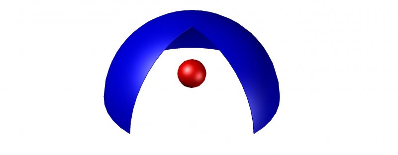

bjenk8100 Posted August 31, 2011 Author Posted August 31, 2011 finally figured it out. arc, revolved around vertical line, i didnt see some of the snaps before, one of them gets rid of circle Quote
ReMark Posted August 31, 2011 Posted August 31, 2011 Houston, we have liftoff! Yeah! Glad to hear you have achieved success. Quote
Jack_O'neill Posted August 31, 2011 Posted August 31, 2011 I'm not at my cad machine so hopefully I can explain this without a picture. Draw the arc for the dome only just do half of it, from the center down to the side. As if you were drawing a vertical cross section. Then offset that arc the thickness of the material you're making it out of. Connect the ends of the arc, making sure that the ends at the top are connected with a vertical line. Pedit all this into a polyline and revolve it around the vertical line at the end. You should end up with a hollow dome, no hole in the center, and it will be the thickness of the material you are making it out of. Quote
