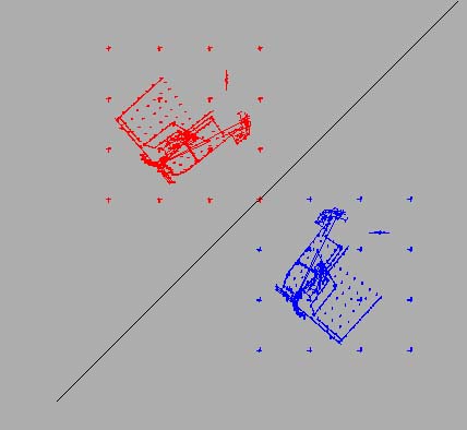

A while back, I sent some dxf files (all made in AC Lt 2010) to a company that uses a system called DP/Com. Apparently, this program reads coordinates (Y,X) instead of (X,Y), which means that they think all of my files are really wierd :ouch:. Each and every number in the coordinates of my points are correct, so it's just the order I want to change.
Is there any way to "switch" the coordinates of several points at once in AC? (Without having to extract a coordinate list, switch columns in Excel and then importing them back...?)
Have you tried mirroring the whole drawing about a line drawn from 0,0 at 45 degrees. The mirrored drawing will have all x and y coordinates changed around. :D
This is going to sound really stupid, but how would I go about to draw such a line...?
Start the Line command, and where it wants a first point, type 0,0 (enter) then when it wants a next point, type 200,200 (enter). Then finish the Line command with another (enter).
There are several different ways, but the above is probably the simplest. :D
You're a genius! Thank you SO much, you saved my day, my week, and possibly even my month! :D
