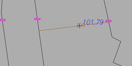

Acad drawing is available with survey contour. Is there any autolisp or codes which will find elevation of intermediate unknown points from nearby contours.
Are the contours 3D lines? If so, can you draw a line from one contour to another (using Nearest Osnap), and then break the line at your required point and ID the end of the line.

Simple maths draw a line from start contour dist1 extend to next contour dist 2 the ratio dist1/dist2 * ht diff + level 1st contour = elevation if I wrote it right.
Having Acad full version. My problem is, there are so many points outside contour lines and with some lisp I want to assign 'Z' to those point/ Text by interpolating contour values in drawing.

Available contour drawing ts attached. Want to find 'Z' for Text point shown as value '100', by referring contour elevation and distances.contour.dwg

To get the level at your point, first of all draw a line (NOT a polyline) at approximately right angles to the nearest contours (using the Osnap Nearest) so that the line passes through the desired point.
Then ID the line where you want the level.
Here is a very old program of mine that might help, tweaked for the purpose of this post:

Pick two points running across your contours and the above will create a 3D Polyline with vertices at the elevations of the contours.
