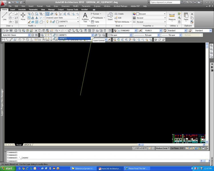

momdrafting Posted August 17, 2011 Posted August 17, 2011 I need some advice, help! We are running AutoCAD versions 10, 11 and 12 in this office. This week two of the machines started having no drop down on their layer toolbar. When you open layer manager the layers are all there, but the drop down shows just the one. attached is a screen shot(I hope, lol) Cindy Quote

momdrafting Posted August 17, 2011 Author Posted August 17, 2011 tried rebooting. nothing changed. we are using xrefs. when we reconcile the layers, it happens. before we do that, the drop down works. Quote

momdrafting Posted August 17, 2011 Author Posted August 17, 2011 The drop down box will not drop down! Shows just one layer. You can open up layer manager and they are all there. This happens after we reconcile layers coming in with an xref. Any ideas? Quote
rkmcswain Posted August 18, 2011 Posted August 18, 2011 Make sure you do not have any layer filters set and that filters are not applied to the drop down (layer settings dialog). Quote

Tiger Posted August 18, 2011 Posted August 18, 2011 If you have opened the Layer Manager, and filtered your layers there of some kind, then the drop down menu only shows those layers after the sort - its the most common reason I see this with my co-workers acads. Quote

wickedverve Posted October 19, 2011 Posted October 19, 2011 I was having the exact same problem as momdrafting, my drop-down was missing and I am using the ribbon menu in Arch 2011. I have rebooted, cleaned, updated drivers, etc., no change. I only noticed the problem after downloading an AutoCAD Product Update a few days ago, but I'm not 100% confident the two are related. I opened up an older version of the same file and my drop-down menu is back in action. So, after my computer failed and AutoDesk installed a new update, after re-opening the current file, seeing the drop-down was still missing, then going into the Layer Properties manager and selecting "All," the menus reappeared. I would say the problem is "fixed," except now I cannot go back and reproduce the problem to see if it is a software error or user error. Comments? Quote
jazzaus Posted January 31, 2012 Posted January 31, 2012 i ran into this issue. when i opened the layer properties pallete, clicked on All, to show all layers and then back on what was the current filter of "All Used Layers", my drop down then showed all layers. Apparently it thought there was a filter in place and this action reset what it needed to show in the drop down which was all layers. Hope this helps someone with this issue. Joel Quote
