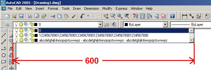

here's the link to the device - it's called FixCombos. i've tried the 200x version, and just get this error message:
cxfixcombos16.arx is incompatible with this version of AutoCAD. AcRxDynamicLinker failed to load 'c:\autocad2011 support files\lisps\cxfixcombos16.arx'
C:\Program Files\Autodesk\AutoCAD 2011\acad.exeUnable to load CxFixCombos16.arx file.
thanks for any help chaps.

ObjectARX (aka ARX, a C++ API for AutoCAD), is version dependent. Meaning, every time the database (read file format) changes there's a new version. For example:
R18.0, R18.1, and R18.2 all use the 2010 file format, and will support the same *18.arx file.
Edit: Provided the source code uses the R18.0 compatible .NET Framework functionality.
What we need to resolve this issue is the source code for one of the tools that does the job for a previous version, then recompile for the current version(s), and their applicable .NET Framework:

Well it is interesting that there are two versions, one for all 200x exept 2004-2006 and one for 2004-2006. What was so different about 2004-2006? Does this work in 2007, 2008 or 2009?
I can only speculate, as I am very new to .NET development, let alone that of ARX. That said, I can say that an ARX file that works in 2004-2006 (*16.arx file) will not work in 2007-2009 (*17.arx file), or 2010-2012 (*18.arx file).
Edit: 64-Bit applications also require a *##x64.arx file be compiled separately from the 32-bit *##.arx file. For example, see Autodesk Labs MDITabs plug-in.
I know ARX has been around for some time, and given that 2006 (R16.2) uses .NET Framework 1.1, I am unsure of the limitations prior to .NET Framework 1.0 as it pertains to AutoCAD.
*IF* we cannot gain access to the source code, I feel there is little that can be done, short of writing this code from scratch. Being only loosely familiar with the .NET API in general, I am unsure of exactly how much, or little work is actually required.

I saw a post by alanjt here http://www.theswamp.org/index.php?topic=39664.0 and made me think of this thread
Seeing the pic Alan posted I drilled down until I got to tab with combo control and change min width to make it longer(OOC)
But, that has no effect on the TOOLBAR Layer Control, that is for the RIBBON.
DOH!
The dropdown for the toolbar, I missed that one important detail.
