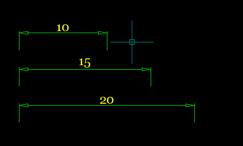

No, use "" to represent the dimension string otherwise your dimensions won't update and you'll screw up your drawings.
I reference the existing text override so that it is not overwritten.
When it prompts for a Prefix/Suffix, type "Prefix" or "Suffix" or, if you already have the dimension and prefix and want to add a suffix, just type "Suffix".
EDIT: Added GIF to demonstrate...
