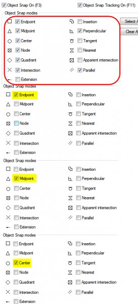

bobsun Posted August 16, 2011 Posted August 16, 2011 Hi, When using object snap feature, if a particular point has multiple roles, by which I mean it could be {endpoint, node point, circle, intersection, etc.} at the same time, is there a way to toggle the snap point selection? For example, does there exist Key or key combination 1: Change the object snap mode to “single” amongst all enabled modes. Key or key combination 2: Iterate one by one through all available modes. Is it possible in AutoCAD? Bob Quote
Tyke Posted August 16, 2011 Posted August 16, 2011 Move your cursor to approximately where you want to snap to and then whilst in your command repeatably press the tab key to cycle through the snap options. You can also have a button on a palette with which you can preset your favorite snaps, the command string could be ^C^Cosmode;1; for end point, ^C^Cosmode;4; for center or ^C^Cosmode;5; for end point and center together. Quote
bobsun Posted August 16, 2011 Author Posted August 16, 2011 Tyke, TAB worked, thanks. What is CODMODE? I typed it and AutoCAD says it is not a command; nor could I find it in help. How do you do the preset? Could you explain in more detail? Bob Quote
Tyke Posted August 16, 2011 Posted August 16, 2011 The command (system variable really) is OSMODE and its a system variable that holds a numeric value for the currently active object snaps. ^C in the command string is equivalent to pressing the escape key. The sample command strings are composed of two escapes ^C^C followed immediately (no space) by the system variable name OSMODE, a semicolon which is the same as pressing enter, the numeric value you want to assign to the system variable and finally another semicolon to finish off the command string. There's plenty of information about on the macros that can be used in a palette button. Quote
