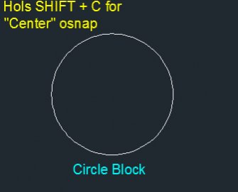

troggarf Posted August 20, 2011 Posted August 20, 2011 Start Line command Use the Center OSNAP or use the snap override (hold SHIFT + C) to start the line With Dynamic input turned on - hit the TAB button to set the angle. After you enter 45 hit TAB again to specify the length or just place the line then trim where it intersects the circle. then start a new line from the line + circle intersection and use the same dynamic input feature. After learning this dynamic input technique, I have not used the polar function in over a year... The attached picture is supposed to be an animated GIF but is aint very animated... Quote
Edgtrimmer Posted August 22, 2011 Author Posted August 22, 2011 Thank you for your input. Before the help I received in this forum, I had been doing something very similar to what you do. After starting the line command, I would right click my mouse to pop up object snaps and then hit the letter 'c' for center to pick the circle center. I have gotten used to polar tracking, so drawing the 45 degree angle from the circle center was no problem. Finally, I would trim the line from inside the circle like you do. Using object snap tracking and polar tracking, I can just hover over the circle, then its center to light-up the center snap symbol, then move approx. 45 degrees toward circle until the intersection symbol lights up and pick the circle to start my line at 45 degrees from circle center at the intersection of the circle (can't have 'nearest' running osnap on). Takes a little practice but it eliminates any trimming after drawing the line. Quote
