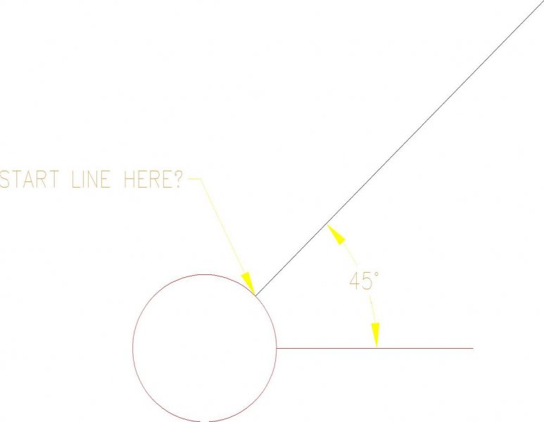

Edgtrimmer Posted August 15, 2011 Posted August 15, 2011 Anyone ever come up with a good way to start a line at one of the 45 degree angles of a circle block? Easy to snap to quadrants or center. Thanks for any ideas. Quote

Edgtrimmer Posted August 15, 2011 Author Posted August 15, 2011 I haven't used this forum much, but below is a jpg of what I'm talking about; thanks. Quote

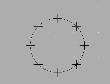

eldon Posted August 15, 2011 Posted August 15, 2011 Perhaps you could take the time to first of all use Divide with 8 segments, then you would have points where you wanted to start all your lines Quote
Jack_O'neill Posted August 15, 2011 Posted August 15, 2011 Anyone ever come up with a good way to start a line at one of the 45 degree angles of a circle block? Easy to snap to quadrants or center. Thanks for any ideas. If you actually make the circle into a block, you can rotate it 45° and use the quadrant points. Inside a block, they rotate with the circle. Quote
alanjt Posted August 15, 2011 Posted August 15, 2011 You could draw your line from the quadrant, then rotate (or rotate with copy option) line with the center of the circle as the basepoint 45d. Quote
Edgtrimmer Posted August 15, 2011 Author Posted August 15, 2011 I have rotated the circle block before to use the quadrants. Often I need to snap to the 0-90-180-270 degree angles of the block as well and then the quadrants are rotated out of position for that. Adding some nodes to the block at 45 degree increments is an interesting idea. Quote
Edgtrimmer Posted August 15, 2011 Author Posted August 15, 2011 I usually just snap to the center and them use the circle of the block to trim the line. That's probably as easy as rotating the line after the fact. I have a simple macro that will allow snapping to 15 degree increments of a circle but it doesn't work on circles embedded in blocks. Quote

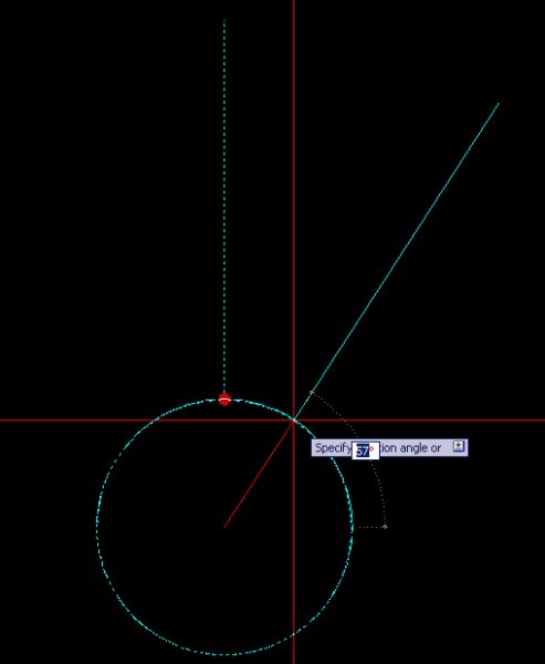

Jack_O'neill Posted August 15, 2011 Posted August 15, 2011 I have rotated the circle block before to use the quadrants. Often I need to snap to the 0-90-180-270 degree angles of the block as well and then the quadrants are rotated out of position for that. Adding some nodes to the block at 45 degree increments is an interesting idea. The nodes are probably the best way. You can change their positions by changing how many there are using the divide command. Of course, if you wanted to get silly, draw a circle, make it a block, rotate it, then lay another circle on top of it. ( for the humor impeded members of the group, that was not a serious suggestion). However, this one is. You refer to a circle block. Not sure what you may have in your circle block, but you might consider doing this a couple of other ways too. Add a line to your circle block, only make it a dynamic block with a rotation parameter. Then you'd only need to drag the line to the angle you want after inserting the block. Quote

Jack_O'neill Posted August 15, 2011 Posted August 15, 2011 And the second way, if I hadn't hit the post button before I was finished, was to simply add a parametric angular constraint to the line that references something in the block that's vertical or horizontal. You could even add a line and the parameter in the block, then erase them both when you have it where you want it. Quote

Jack_O'neill Posted August 15, 2011 Posted August 15, 2011 With a rotation parameter, all you have to do is click on the block to turn on the grips, then click the round grip where the line hooks on. You can either drag it where you want it or type in an angle. Put it any where you want it. Quote
