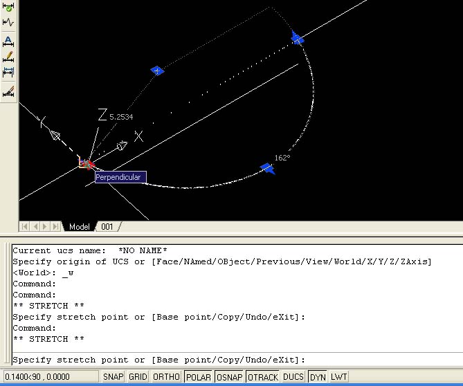

steelstacker Posted October 10, 2008 Author Posted October 10, 2008 Yes, I'm familiar with 3d and have used it to lay out frames but never with arcs. I've tried the stretch command using the end of the pline as my stretch from point, I've tried moving the vertex from within the pedit command..... but nothing is working. I really hate to make this a field cut part. If I'm having a hard time here, I can only imagine the problem they'd have 20' up in the air at the jobsite. It's been years since Calculus, and I don't even really know where to begin in calculating it. Any other suggestions? Quote

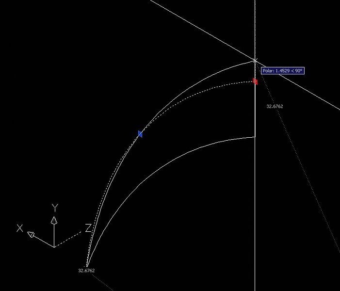

nocturne00 Posted October 11, 2008 Posted October 11, 2008 I assume your trying to accomplish something like this? or do you have something else in mind? Quote

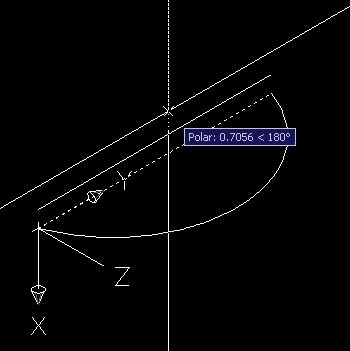

SEANT Posted October 11, 2008 Posted October 11, 2008 I’m interpreting the drawing as something like this. If that is true then a general question which needs addressing would be; should the beam be an arc rotated off horizontal (elliptical in Plan) to simplify beam fabrication, or should the beam be an arc in Plan (elliptical in the 4 5/8:12 plane) to ease construction of subsequent features – a curtain wall perhaps. The attached is an example of the latter. BentBeam.dwgFetching info... Quote

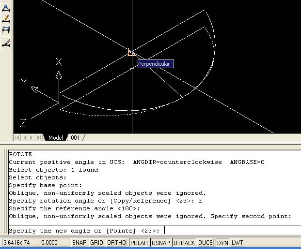

nocturne00 Posted October 12, 2008 Posted October 12, 2008 Ok I got it, first copy your W18X40 beam to 3'-6 11/16", or just reorient your UCS then offset it to that distance. then rotate(with reference) your Arc using its midpoint as your base, then snap it on the offset W18X40 beam. the grips of your arc can now be adjusted to snap at the ends of the W18X40 beam. after, just Pedit your arc then check out its properties to see the length Quote
