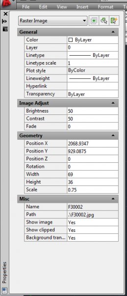

Thank you for answering. I believe there must be a way to actually do the scaling of raster image. I will have to dig deeper. Meanwhile I have tried to print the image in monochrome, none, grayscale and change values of transparency to yes and no, clipped image to yes and no and nothing to no avail. In Photoshop, I can delete the white background but as soon as I save the image to jpeg or any other format, the white background automatically appears. I believe this has to do with one Autocad 2011, Autocad 2012 settings because as I checked in old catalogues done by predecessors in older versions of Autocad, there were no background in their printing. Clear images.
I have attached one of the inserted raster image properties.
