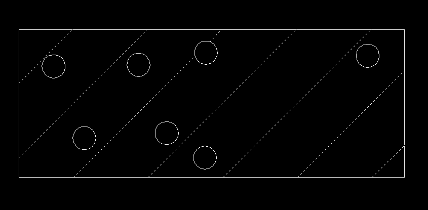

I'm using your Areas2AttributeV1-2.lsp and it works great, especially adding the total to an attribute, but it's not quite what I need.
I'd like to be able to ADD one polyline, such as a building outline, then SUBTRACT multiple polylines, such as staircases and elevators.
Any help you can provide would be much appreciated.
  Thank you very much.
  • 2 months later...
I'm checking back in on this thread.
 This LISP works great, but would like the option to ADD one polyline, such as a building outline, then SUBTRACT multiple polylines, such as staircases and elevators.
Thank you.😀
This was answered in another post maybe on another forum. You can have a room say with say  columns and get floor area.
Anyway the simple answer is if you can make a hatch that reflects the correct shape then you can get the area, so would need to edit Lee's code to pick a hatch rather than a pline.
  • Thanks 1
Thank you BIGAL for the response.  I hadn't thought of selecting hatch rather than a polyline.  This seems to solve my question, from a certain point of view :)
