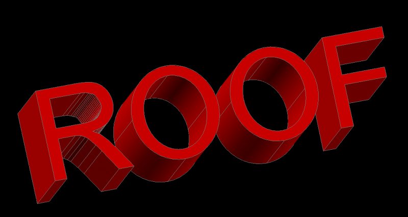

Jack_O'neill Posted August 7, 2011 Share Posted August 7, 2011 Actually, drawing roof in 3d is pretty easy to do: Quote Link to comment Share on other sites More sharing options...

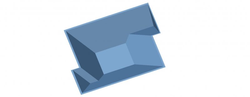

Bobzy20 Posted August 8, 2011 Author Share Posted August 8, 2011 Wow what type of roof is that called!? Ok please see the attached cad file (zipped) - you will see my version of the roof although I'm not sure if that's the correct way to draw it. Quote Link to comment Share on other sites More sharing options...
ReMark Posted August 8, 2011 Share Posted August 8, 2011 The roof has already been constructed as a solid. I think you need to use the SHELL command next. Quote Link to comment Share on other sites More sharing options...
Bobzy20 Posted August 8, 2011 Author Share Posted August 8, 2011 Yeah that's my attempt but the roof covers the front wall of the house which it shouldn't. Also I can't shell it as it says: modelling Operation Error: No solution for a vertex. Quote Link to comment Share on other sites More sharing options...
ReMark Posted August 8, 2011 Share Posted August 8, 2011 Well there is a less subtle way of doing it. Make a copy of the solid. Scale it to something like 98% of the original. Subtract one from the other. Do this with a copy of your original. Should look something like this as viewed from the underside. Quote Link to comment Share on other sites More sharing options...
rvpas Posted August 8, 2011 Share Posted August 8, 2011 Hi every one, An other idea ! I had the same trouble in couple years and I noticed my model was create to far from origin and its units is millimeter. To solve my problem I used scale command to change its scale and editing solid worked again. So I do the same thing with your roof and shell works. I found discussion about this problem in autodesk see link http://forums.autodesk.com/t5/AutoCAD-2007/SOLIDS-limitations/td-p/1636625 I I include your roof 1000 times as smal, in meter maybe it's a same problem in inch Roof-rvpas.zip good luck Pascal Quote Link to comment Share on other sites More sharing options...
ReMark Posted August 8, 2011 Share Posted August 8, 2011 Why scale it that small? Couldn't you have just moved it closer to 0,0 if that is at the root of the problem? Quote Link to comment Share on other sites More sharing options...
rvpas Posted August 8, 2011 Share Posted August 8, 2011 Hi Remark, In France, we work in meter in the construction of buildings and rarely otherwise. For the exposed case, it was a plan of house drawn in the mm and geolocalisation with the site about X: 1500000 Y: 5200000 Z: 196000. That's why I had the reflexe to make the same thing with the roof because I measured a door which mesuring 1200 drawing units. And I don't change a position because the origin it was at the corner of house Have a good day Pascal Quote Link to comment Share on other sites More sharing options...
