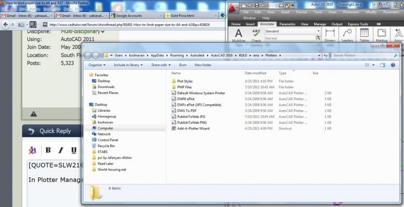

In Plotter Manager (Inside ACAD) I couldn't find printer PROPERTIES. Please see attached photo.
PlotStyle Manager also didn't have the printer PROPERTIES. Am I missing something?
Your plot dialog box inside AutoCAD.

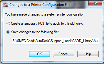

When I want to save changes I have made, it asks following question:
You have made changes to a system printer configuration.
Create a temporary PC3 file to apply to this plot only.
Save changes to the following file:
If I want to make this change permanent, then I have to choose the second option. Is it true?
yes, that's correct. u have to choose second option to make it permanant

When you make the changes like SLW210 suggests,it will pop up with this box.
Save changes to the pc3 file you want to use.

On that window, I chose the second option (Save changes to the following file:), but save didn't appear in next start up.
Is this "Save" associative to that file only? I want to save it for all ACAD files I have.
First option clearly says that this changes is only for "this plot" only but the 2nd option doesn't say whether it is a global change? Also I didn't change the file name or path.
I checked and saved again and still all other pages appear in the box. In between it asks that this file already exists do you want to overwrite and I say "yes"
